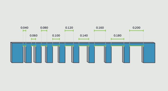

If you’re ready to climb aboard the DMLS express, there are a few things you should know first. Although the technology produces fully dense parts from high strength, corrosion resistant metals, certain part features are prone to warping and curl if not supported properly during the build process. The design of build supports isn’t something you as a product designer or engineer necessarily need to be concerned with, but you do need to know that some shapes are exceptionally difficult to build, and by altering your part design somewhat, costs may come down while product quality goes up.

Let’s start with the letter A. Unless the horizontal crossbar is less than 0.080 in. across (2mm), vertical supports will be required beneath it to prevent warpage. Not a problem, but it’s going to cost a bit to grind or machine those supports away after the build. Same with a T—without supports beneath the overhanging top section, it’s going to curl up like a goalpost. Letters B, D, P, and R are especially problematic because the supports will be left inside the part, where they’re most difficult to remove. Curved shapes like O and Q fare no differently, unless the letters are quite small, about the diameter of a soda straw. In fact, about the only letters that won’t need any form of support are X and Y, provided the arms are angled at least 45 degrees from the horizontal.
