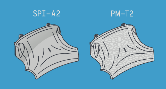

All polish and texture is applied directly to the mold itself and transferred to the parts during the injection molding process. For this reason, secondary finishing is not available, which makes material selection critical in some cases. Typically, the link between the surface finish and material is small, but glass, mineral, or soft and high-shrink materials can produce parts that don’t always reflect what you may be looking for in a finish.
Below are images depicting each surface finish option for injection molding.
Glass- and mineral-filled materials provide unique material properties that unfilled materials don’t, but be cautious when using them if they are intended to be a highly cosmetic part. Glass and minerals can create material streaking and the polish can even be difficult to distinguish between grades. This isn’t the case with all filled resins, but we suggest speaking with one of our applications engineers (AEs) or requesting a material sample plaque of the actual material you intend to use.
At Protolabs, you’ll receive a fully interactive quote with design for manufacturability (DFM) feedback that highlights problematic areas where increased attention should be paid—a textured surface may have more draft requirements than a polished surface would, for instance.
Draft is required for two reasons: to provide proper release from the mold so you can avoid scratches or drag marks on your part, and to provide a proper angle for a bead blast finish to be applied to the mold. A minimum of 3-degree draft is required for a PM-T1 finish and a minimum of 5 degrees for a PM-T2. Additionally, finishes on deep and thin ribs may not be possible on parts as they are challenging to reach within the mold.
