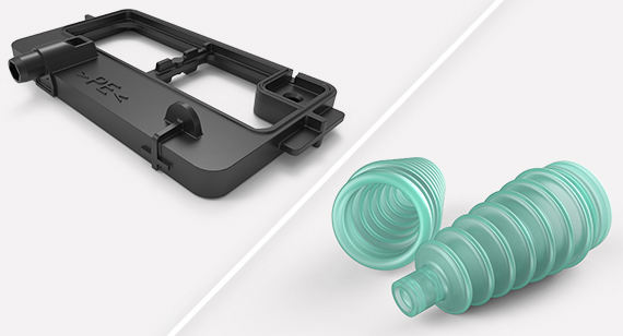

For thermosetting polymers, Protolabs offers a variety of liquid silicone rubber (LSR) materials.
LSR is a common thermoset and is a useful material because of its superior flexibility and heat and chemical resistance. Typical applications include soft-touch surfaces, gaskets, and heat insulation. Molders mix two components of uncured LSR to form a relatively low viscosity “liquid rubber” solution. The material cures in the presence of heat forming a bond that can’t be undone.

The polycarbonate part (left), is a common thermoplastic material used in injection molding. The liquid silicone rubber (LSR) part (right) is a popular thermoset material choice.
