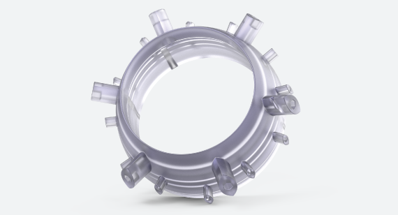

One UV-resistant polymer that can be 3D printed (and machined or plastic injection molded) is polycarbonate (PC). Material providers are quick to point out, though, that the resin used in stereolithography (SLA) 3D printers is “polycarbonate-like” and not a true polycarbonate. No matter, the properties are quite similar, and from a design perspective, the two are essentially interchangeable. PC is clear like glass (almost) but far more impact resistant—approximately 200 times stronger, in fact. It’s also tolerant of temperature extremes, making it a good choice for products that see regular outdoor use, such as goggles and face shields, windows for heavy equipment, see-through containers, and more, not to mention containers found in medical applications. Keep in mind though that polycarbonate ranks among the more expensive of UV-resistant polymers.
ultem blocks for cnc parts
With post-processing 3D-printed PC can be finished to a near transparent appearance.

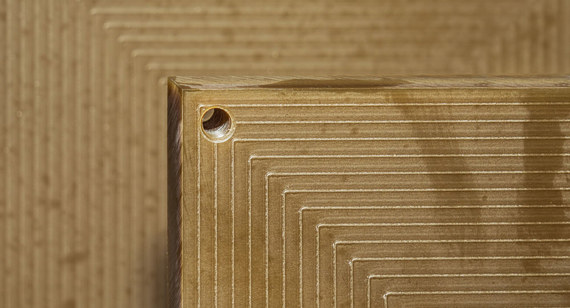

PEI or Ultem is a versatile thermoplastic that can be machined or molded.
PEI or Ultem
So does polyetherimide (PEI), or Ultem. As its name suggests, PEI is an exceptionally high-strength plastic resistant to sunlight, flame, high temperatures, a range of chemicals. It's also an excellent electrical insulator (i.e., has high dielectric strength). Here again, various fills are available to enhance PEI's already admirable qualities even further. It can also be produced in transparent or translucent versions. Because it withstands repeated short-term exposure to hot water and steam, Ultem sees broad usage in autoclaves and the medical instruments that go in them. Automakers use it for headlight reflectors and heat shields, electronics suppliers put PEI to work in connectors, enclosures, and mounting brackets, while aerospace manufacturers use PEI in everything from fuel valves and engine parts to food trays and steering wheels. Simply put, PEI is the switch hitter of choice for a variety of machined and injection molded components.
