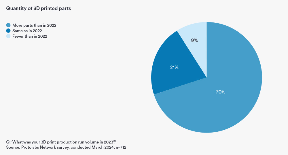

Of surveyed businesses printed more parts in 2023 than in 2022

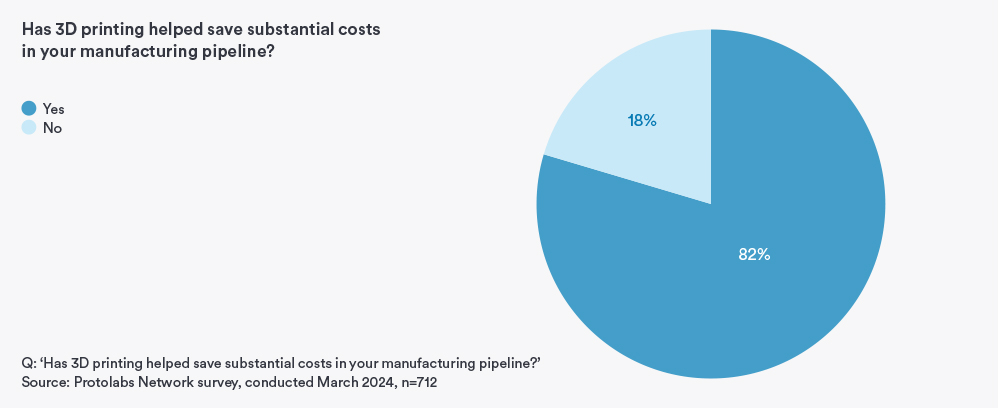

82%
Of respondents said 3D printing helped them save substantial costs

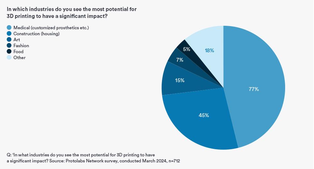

Of respondents think 3D printing will have the most significant impact on the medical industry

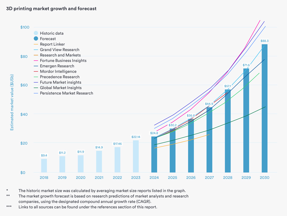

This graph summarizes data reported by leading market analyst firms that evaluated the 3D printing market in 2023, including revenue from 3D printing systems, software, materials, and services, but excluding internal corporate investments in 3D printing technologies. It was collated based on publicly available information and it provides the best estimate of the current size and future potential of the global 3D printing market.
The 2023 market size was estimated at $22.14 billion on average, representing a 26.8% increase on 2022's $17.46 billion. This is far exceeding expectations. It is 10% higher than we predicted in last year's report, which forecast the 2023 market size of $19.9 billion at a compound annual growth rate (CAGR) of 17%.
If we apply last year's CAGR (26.8%) to 2024, the market size would grow to $28 billion. Taking market fluctuations into account, we're using a more conservative growth rate based on averages across the past five years. This arrives at a CAGR of 21% and a market size of $24.8 billion by the end of 2024 and $57.1 billion by the end of 2028.

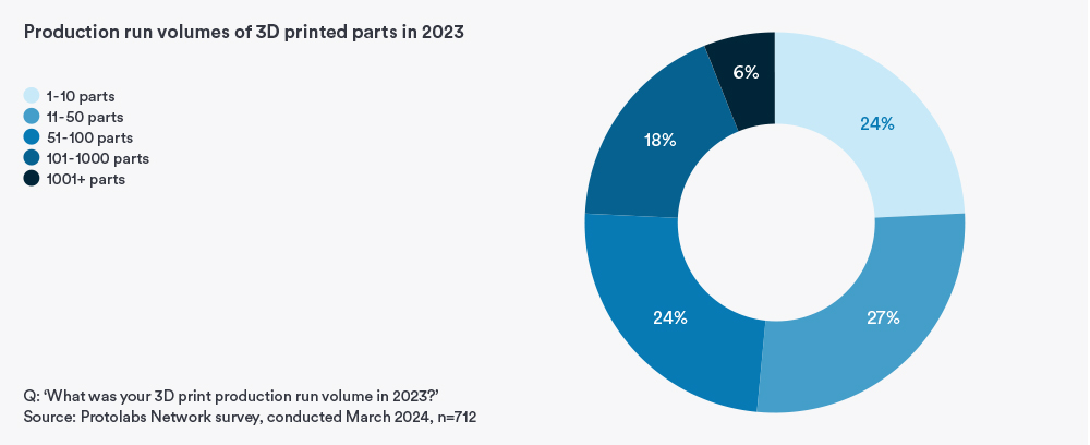

Production run volumes have remained stable in the past year. While in previous years, the number of respondents saying they printed more than 10 parts rose from 36% for 2020, to 49% for 2021, and to 76% in 2022, this figure stayed at 76% for 2023, marking a stabilization. However, there was one shift: the percentage of respondents saying they printed more than 1,000 parts rose from 4.7% to 6.2% compared to the previous year. This may signify a further increase of the usage for 3D printing technology for the production of end-use parts or aesthetic parts rather than prototyping. Indeed, there was a slight increase in respondents saying they primarily use 3D printing for end-use parts in 2023, up to 21% from 20% in 2022.

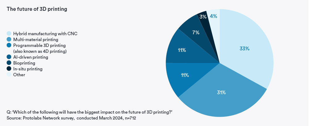

3. Hybrid manufacturing
Processes combining additive manufacturing with CNC machining and other technologies are on the up and up, testing the limits of what can be achieved in manufacturing.
4. Multi-material printing
Enabling the combination of materials with different properties in one printed object, multi-material printing opens the door to a wider range of products being created within additive manufacturing and can remove the need for assembly.

Medical (77% of respondents) |

The increased market growth rate that we observed in our market data analysis was reflected in the survey, where 70% of respondents stated that they had printed more parts in 2023 than in 2022. A total of 21% printed the same amount of parts as they had printed 2022, and just 9% printed fewer parts than in the previous year. The industries in which the percentage of respondents stating they printed more parts than in the previous year was the highest were agriculture (87%), electronics (83%), transportation (83%), construction (79%), and medical devices (75%).

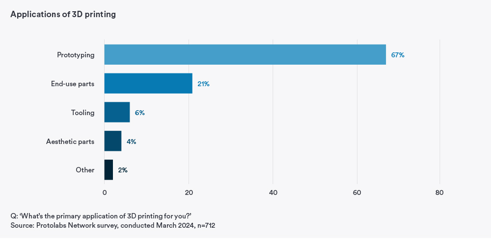

Looking at the "applications of 3D printing" chart below, 67% of respondents said they used 3D printing for prototyping, while 21% use it for end use parts, but the breakdown of these applications differs greatly by industry. The industries with the highest adoption of 3D printing for end-use parts were transportation (33%), robotics (30%), and industrial automation (27%). In the design industry, 9% were using 3D printing for aesthetic parts, more than double the average.

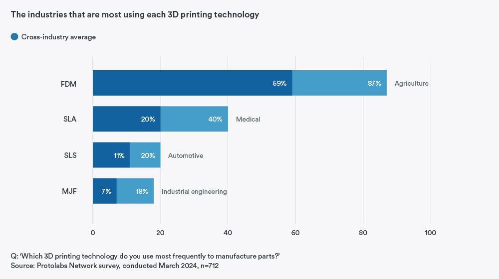

The term 3D printing encompasses several additive manufacturing technologies that can differ in material selection, surface finish, durability, and manufacturing speed and cost. When we asked our respondents which they used more frequently, they said:
- FDM: 59%
- SLA: 20%
- SLS: 11%
- MJF: 7%
Breaking this up by industry, there are some notable differences to the above averages.
For instance, in agriculture, 87% used FDM most frequently, and in construction, it was 79%. On the flipside, only 42% of respondents in the medical industry used FDM most frequently, as it was more highly skewed towards SLA, with 40% of respondents using it most frequently—twice as many as the 20% average.
Biotechnology is another sector where a relatively high percentage (25%) of respondents used SLA most frequently, while automotive had the highest adoption of SLS—20% compared to the average of 11 percent.
Finally, when it comes to MJF, two industries used this much more frequently than the 7% average: industrial engineering (18%) and electronics (15%).

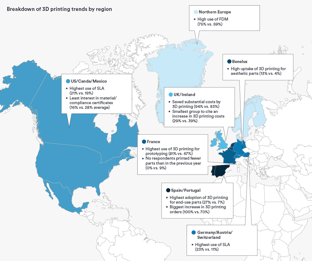

Our survey demonstrated a distinct difference between the regions in how respondents were using 3D printing. The percentages below show regional trends versus global averages.

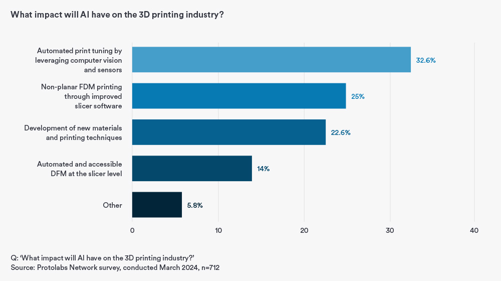

The emergence of AI has been so fast-moving, so wide-ranging, and so disruptive in almost every industry, it's clear that it'll have an impact in the 3D printing space, too. The question is in which part of the process the technology will be most consequential. Of our survey respondents, 14% think AI will have the biggest impact by providing automated and accessible DFM at the slicer level; 23% think it will be the development of new materials and printing techniques; and 25% think AI will improve accessibility to non-planar FDM printing through improved slicer software. The largest group of respondents, at 33%, see AI having the biggest impact at the hardware level, through enabling automated print tuning by leveraging computer vision and sensors.
"Like every industry today, 3D printing is capitalizing on the excitement around next generation AI and automation tools," says François Minec, Global Head of 3D Polymers, HP Personalization and 3D Printing at HP. "Advancements in 3D hardware, firmware, and software are bringing data analytics and KPI monitoring to the forefront, enabling scalability for even more manufacturers."
Adam Hecht, co-founder and director of Additive Manufacturing at DIVE, a design agency specialized in industrial additive manufacturing, agrees that it's the hardware where AI is going to be most helpful. "Right now, we have a lot of smart printers that are very dumb. They will say something is wrong without specifying what it is. That's very frustrating for a lot of consumers and companies. But as the systems get smarter, they can actually help users to self-diagnose, or dial in new materials, for example—I think that's where we're going to see a lot more adoption."
"In terms of quality control, most of what I've seen has been in-process monitoring," says Eric Utley, 3DP applications engineering manager at Protolabs. "There's definitely research going on in that area, and I can certainly see it being offered commercially in the next couple of years."
Alex Huckstepp, advanced-manufacturing expert and co-founder of a still-stealth manufacturing software startup, agrees. "Process control—anomaly detection and closed-loop feedback opportunities—would be a frontier where AI and machine learning could have an impact."
When it comes to generative design, Hecht thinks AI's impact may be more limited. "Generative design works fairly well in terms of topology optimization. But I wouldn't say it's too universally helpful, other than for very specific parts of the industry such as aerospace, automotive, or medical, that are creating very high-performance, lightweight parts. It works out really well in those."
AI can also be help for consolidating the many elements of designing for 3D printing, from optimizing to adding lattices and surface textures such as basket weaves. "There's so much you can do to a part because you have so much freedom in 3D printing," says Hecht. AI-assisted programs can help with combining these elements in one step to make the design process easier.
"We're starting to see interesting tools on the design side—designing within manufacturing process constraints in a much more automated, optimized way," says Huckstepp. "Then there's Multiphysics process simulation—there's some really interesting AI tools emerging there."
"AI-generated CAD is accelerating quickly," adds Utley. "And NASA has been promoting their software, which is much more manufacturing focused, and a lot of that is really, really interesting." The software generates optimized designs in line with the parameters specified by engineers. "It's tuned towards specific manufacturing processes and is actually doing topology optimization," Utley says.
But you don't have to be working at NASA level for AI to be useful for you—in fact, the skill and constant practice required, for example, to be efficient with making 3D CADs means AI assistance can significantly accelerate and simplify these processes, not to mention present an appealing proposition to engineers who are less familiar in the design space. "I think an important factor stopping people from ordering 3D printing is not knowing how to design," says Robin Brockötter, supply chain manager at Protolabs Network, "and I can imagine that AI will make this a lot easier."

In 2023, 21% of our survey respondents used 3D printing for end-use parts—up from 20% in 2022—and 4% used it for aesthetic parts. When it comes to replacing injection-molding manufacturing with 3D printing processes, it's all about order volumes: for low-volume production, 3D printing is often the more cost-effective solution, while at higher volumes, injection molding becomes more economical. However, the point where that happens—the 'sweet spot' of maximum viable 3D printing order volume—is shifting. "3D printing can now start producing more and more parts before injection molding becomes cheaper," says Brockötter. Results from our 2024 survey support this. In our 2023 survey, doubts around 3D printing as a choice for "production volume and scale" led 47% of respondents to opt for different manufacturing technologies, but this year that number has dropped to 45%, showing increased confidence in scaling with 3D printing. And throughout the years, our surveys also show a steady growth in production-run volumes: respondents saying they printed more than 10 parts rose from 36% in 2020, to 49% in 2021 and to 76% in 2022. While this figure has stayed the same for 2023, marking stabilization, the percentage of respondents saying they printed more than 1,000 parts rose from 4.7% in 2022 to 6.2% in 2023.

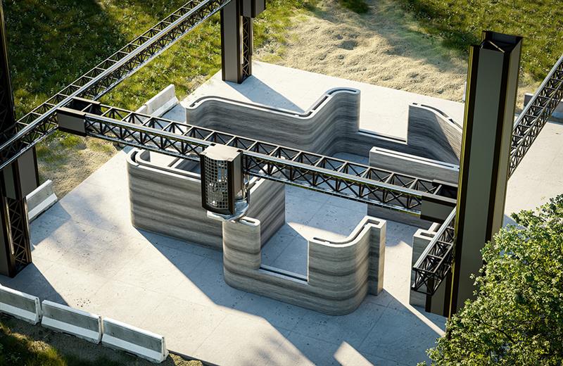

At the other end of the scale, Hecht expects a significant push for large-format 3D printing, for applications such as tooling or furniture, helped along by new, larger systems such as robotic pellet systems. These systems offer greater design freedom, complexity, and production flexibility. They can also eliminate, or at least reduce, the substantial amounts of waste associated with machining large parts, and drastically cut down the labor needed to manually fabricate large structures from many smaller parts. "It's a really interesting next step for various industries, and it opens a new door to possibilities for larger pieces—and we're seeing a lot more companies are jumping on that wave as well."
In addition to furniture, boats are another example where 3D printing can significantly save on manual labor costs and material waste. Large-format printing is also being utilized for art and marketing purposes, and, of course, there's the aforementioned houses. "Printing housing in concrete seems to be growing quite a bit," says Utley.
Hecht also thinks that in certain circumstances, large-format polymer printing can replace sheet-metal parts. "Where speed, agility, and complexity present a challenge for conventional sheet-metal manufacturers, large-format printing is a clear winner. It reduces minimum order quantities and enables the design to evolve without additional costs. Small sheet-metal parts are hard to compete with, but for large ones, the constraints begin to add up and printing becomes a contender."
Of course, there are limits. For simple shapes made from metal, conventional manufacturing processes often remain the most efficient. Alex Huckstepp mentions the time when there was an ambition to 3D print an entire rocket, "before they realized that 3D printing a big cylindrical tank is not a cost-effective way to make that big shape. You can just roll a piece of sheet metal and do it how everyone else does." In short, you don't always need rocket science to build a rocket.
