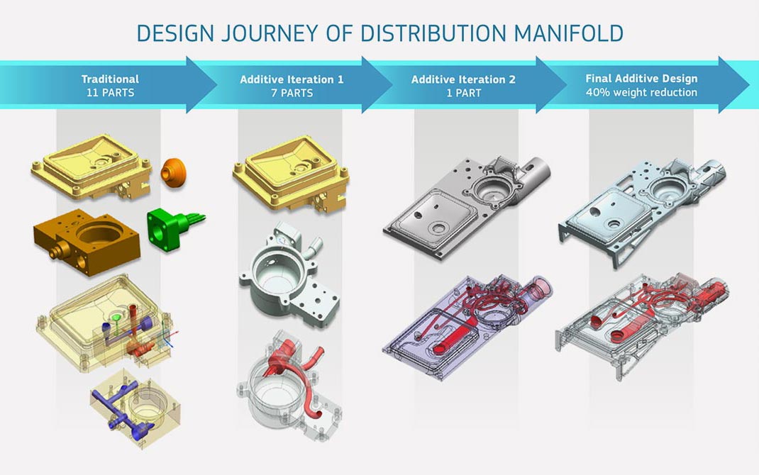

Typically, it is not enough to think in terms of combining two parts—ideally, think in terms of 20-plus parts if you can. The more parts being combined, more than likely the greater the savings. If pieces are fixed once assembled, that may be an opportunity for consolidation. The more challenging to assemble as it exists now, the better. In additive manufacturing, complexity is often free—the most successful parts take advantage of this axiom as much as possible.
The best-case scenario, and what every engineer should strive for, is to not just find cost savings but also improved part performance with additive manufacturing. A combined assembly will typically have fewer points of failure and added strength from a unified part. Look for applications where either of these would be big wins and not small. Internal cooling channels are easy to incorporate as well, potentially giving way to benefits such as reduced part fatigue. Fulfill your full design wish list—the unmanufacturable can be suddenly made possible, so create the best part you can.

Since reducing assemblies equates to cost savings in a more nebulous sense, it is often easier said than done. At a basic level, you may be able to take multiple traditionally made parts in your 3D CAD assembly file and export them as one piece to create a solidified “Frankenstein” part, which theoretically could be produced with additive manufacturing. We often see these and are asked “can you make this?” to which the answer is often “Yes!” However, this doesn’t mean the result will be cost effective, of high quality, or a performance improvement. Just because additive manufacturing provides near unlimited design freedom, this doesn’t mean every part is cost effective or well-suited for the technology.
It may be worthwhile to think about your application at its most basic level and ask what the fundamental design requirements are outside of manufacturability concerns, and work backwards from there. Designing effectively for additive manufacturing often requires “unlearning” the manufacturing limitations baked into your mind from years of working within them. If an aspect of your additive part exists because in a legacy version it was typical of its manufacturing method, it’s worth asking if it’s necessary anymore.
In a very general sense, material volume equals cost in additive manufacturing. Get rid of anything nonessential for functionality. But remember one of the most foundational rules of additive manufacturing: complexity is free. The key to a cost-effective part is often to add value by making your design as high performance as it can be without the constraints of traditional design.

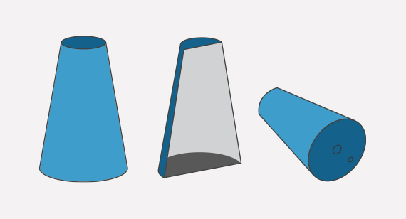

That said, while additive manufacturing provides design freedom unrivaled by other manufacturing methods, it is not without its own rules and guidelines. Additive manufacturing provides a path to production for parts that could never have been made before, including optimized parts made via generative design. It is worth keeping in mind that while an organically shaped part generated by 3D topology optimization software may be theoretically the best possible solution for a given loading condition, this does not mean the part is well-designed for additive manufacturing.
This is especially true when considering technologies that may require support material to form, such as DMLS. These parts may have significant overhangs requiring added support material in the build to form, which increases print time and labor in finishing. Hollow parts may need careful examination of internal overhangs or “bridges,” to prevent added inaccessible internal supports from being required.
However, if you are designing for a technology such as SLS or MJF, which use the powder cake itself to support the part, no need to worry. In this case the only real concern is escape holes for powder removal (as applicable). Clips, latches, and snap fits are commonly made from durable materials within these technologies. Carbon materials also offer engineering-grade material solutions for these types of parts. Similar to DMLS, Carbon materials also require support materials to form. Generally, clips, latches, and snap fits are designed with assembly of multiple traditionally manufactured components in mind. With SLS, MJF, and Carbon, engineering grade nylons (filled and unfilled), polypropylenes, elastomers, and polyurethanes can manufacture these types of parts in one assembly. Stereolithograhy (SLA) materials are not as ideal for these types of parts due to their brittle nature. However, if you are after fit and form, and not as interested in long-term durability and function, SLA can still be an option for you.

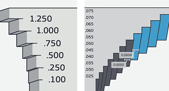

Determining the tolerances possible for any one additively manufactured part can be difficult, since every part responds differently to the thermal stress during the build. In DMLS, well-tuned equipment can lead to typical tolerances of ± 0.003 in. (0.0762mm) in a best-case scenario. For SLS and MJF, typical tolerances are ± 0.010 in. (0.254mm) or ± 0.012 in. (0.3048mm) respectively. Warp or shrink-prone parts can exceed these ranges. Every geometry is unique and behaves differently under the stress of the build. If tight tolerances are required for an additively manufactured part, they generally must be dialed-in with repeated upfront builds or post-machined.
However, a well-designed additive part may still improve the accuracy of what otherwise would be a complex assembly by eliminating tolerance stacking. If you combine 20 parts that previously each had individual tolerances of ± 0.002 in. (0.0508mm) into one part for which you can expect ± 0.010 in. tolerance, the overall accuracy of your assembly has improved. Part of transitioning to additive manufacturing for a product may include letting go of the tight tolerances on a per-part level that you’re used to expecting. In this case, it’s important to not compare apples to oranges—don’t ask if the new part can be as accurate as the parts it is replacing, ask if it can be as accurate as all of them in the aggregate.
