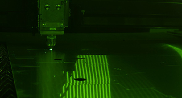

  • CNC laser cutting works with jets of oxygen, nitrogen, helium, or carbon dioxide to burn away metal and produce a clean, finished edge. The speed of this process differs with the thickness of the metal, but the cut can be quite complex and, at tolerances of +/- 0.005 in. or better, is quite precise. And because there is no contact, the tool does not wear out the way a mechanical cutter does. Two types of lasers are used in sheet metal fabrication. Fiber-optic laser are used for thinner and more reflective materials to deliver precise cuts. Multi-gas or CO2 lasers are more powerful and suitable for thicker gauges.

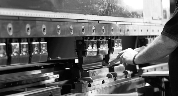

Bending. Most metals can be bent along a straight axis using a variety of presses. The shapes of bends can range from gentle curves, like those along the vertical axis of a steel can, to sharp corners at angles above, below, or right at 90 degrees. Press brakes are used to create these relatively sharp bends. Rolling and forming methods produce open or closed single-axis curves in a continuous bending operation.

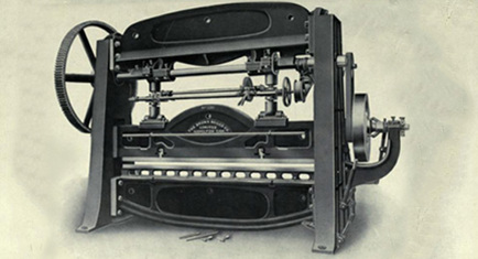

A Brief History of Sheet Metal
Sheet metal has been used for millennia, having reportedly shown up in ancient Egyptian jewelry. It was a mainstay of medieval armor when metal fabrication was still a costly manual process. There was an explosion of sheet metal work beginning at the time of the Industrial Revolution. Today it is in our cars and appliances, can be found in almost any room in the home or office, it encases computer hardware, and is travelling around the world in aircraft and through space in rockets and satellites.
After centuries of hammer-forming, the first rolling mills appeared in the 16th century to produce sheet metal stock, in at least one case using a design originated by Leonardo da Vinci. The 17th century saw the industrialization of sheet metal manufacturing culminating in the creation of the first cold rolling plant in England. The Industrial Revolution of the 18th century saw the advent of assembly line production, press brakes, and the hydraulic press. In the 19th century, aluminum was introduced, the Bessemer converter allowed mass production of steel, and the steam hammer was also introduced. Developments affecting sheet metal production and use have continued at an ever-growing rate into the 20th and 21st centuries making sheet metal today an industry worth tens of billions of dollars.
laser cutting sheet metal machine
CNC laser cutting burns away sheet metal to produce a clean, finished edge.

machine press bending sheet metal part
An example of how most metals can be bent along a straight axis, using varied presses.

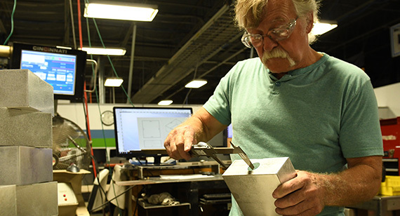

engineer measuring bend accuracy with caliper during sheet metal quality process
Caliper measurements for bend accuracy are part of the entire sheet metal quality control process.

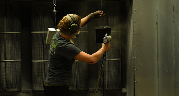

sheet metal finishing process in several ways: powder coating or conventional paint
Sheet metal can be finished in several ways, including powder coating, as seen here, which results in a surface more durable than conventional paint, thought it may lack paint's aesthetic qualities.
