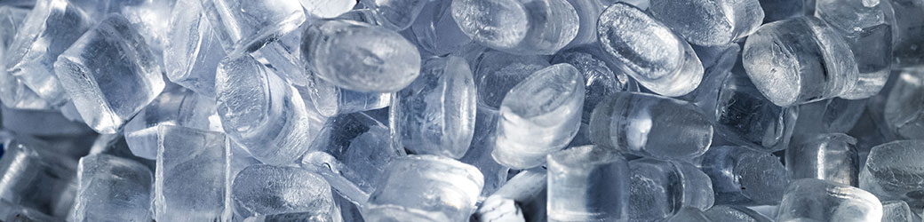

Plastic Materials: Pellets, Resins, and Powders
Choosing the right material for your parts is critical to their functionality and longevity. Beyond pellets, resins, and powders, it also makes sense to mention solid-form plastics, which come in blocks and cylinders, for use in CNC machining. More about those later.
There are two types of plastics: thermosets and thermoplastics.
You can always remember the difference because the end-form of a thermoset part is, well, set. You can’t melt it and use the goo to reform another part. It’s one and done. Generally, thermoset plastics require less heat and pressure to form, but also have high heat and chemical resistance. On the downside, they tend to be non-recyclable.
Thermoplastics are the opposite; while they are built the same way, typically they can be returned to a liquid form and remolded. That said, you do need more heat and pressure to form them into parts. The properties of the parts you get will vary depending on the material you’ve chosen.
Both plastics can be found across the manufacturing ecosystem taking unique journeys to final part based on your chosen service line. If you’re designing medical parts, you have a lot of requirements to adhere to, so you may want to explore some of the more popular plastic materials at a deeper level.
Starting with 3D printing, stereolithography (SLA) uses an ultraviolet laser to cure thermoset resin. When using selective laser sintering (SLS), thermoset and thermoplastic powders are solidified with the zap of a laser. Multi Jet Fusion (MJF) sprays fusing/detailing agents just like an inkjet printer to build out parts layer-by-layer, setting layers of powder as the build progresses.
Injection molding, for example, is more straightforward. You will work with either thermoset or thermoplastic pellets, which are melted into liquid resin so they can easily flow into, and through, a mold. The service also boasts the largest library of plastics. Common materials include:

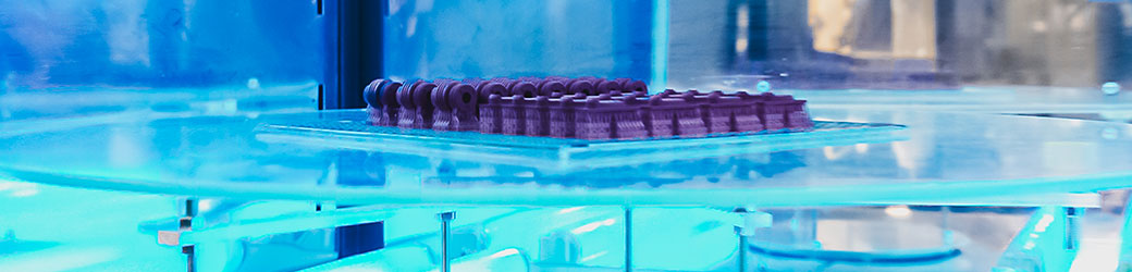

Plastic Manufacturing Processes
Let’s take a look at the primary ways you can manufacture plastic parts, starting with a high-level overview.
Plastic Manufacturing Processes at a Glance
Process | Description | Works Best For |
Injection Molding | Metal molds are milled, then filled with liquid resin that is cooled to form final parts | Large volumes of parts with simple geometries |
CNC Machining | A subtractive manufacturing process that cuts away plastics from a solid block or cylinder using either a mill or lathe | Widely used in aerospace, medical, automotive industries for its ability to rapidly manufacture precise parts in production-grade materials |
3D Printing | Depending on the technology used, parts are built by fusing, sintering, or extruding material layer-by-layer | Low volume, rapid prototyping and production parts with complex geometries for aerospace, medical, automotive, and other large industry sectors |
Extrusion | Applies pressure and heat to softened material, then pushes it through a specially designed die. Think pasta or Play-Doh®! | Long, continuous parts with the same geometry and hollow parts. |
Blow Molding | A hollow tube of molten plastic (parison) is placed in a mold and injected with compressed air, forcing it to conform to the mold shape, and making it hollow | Bottles, fuel tanks, IV bags, drums, air ducts |
Rotational Molding | Plastic powder is placed inside a mold, which is rotated inside an oven, forcing the plastic to melt and adhere to the mold shape | Tanks, storage containers, traffic cones, medical waste containers |
Thermoforming | Plastic film is heated and compressed in a multi-part mold. Vacuum is used to pull the material against the mold to conform to the desired shape | Food packaging, cosmetics, clamshell packs, trim panels, electronics. |

How is Quality Measured in Plastic Parts?
So, you’re about to approve a quote from your manufacturer and you want to know how that company determines whether the part is successful. Some of it starts with knowing the inherent qualities of the plastic you’ve chosen but ensuring that geometries follow your specification is equally important. We’ll cover both.
Note that not every method will be used as this is more of an overview of possible measurements. Options will also differ based on your chosen service line. With 3D printing for example, Protolabs offers both digital inspections and mechanical testing, if desired. We check for defects like surface imperfections, warping, and any issues that may affect performance, safety, or durability.
Material Properties
Let’s start with how we measure key material characteristics. Impact testing is as it sounds—dropping a mass onto the material until it shatters. Chemical resistance measures a material’s reaction to a variety of caustic materials or solvents, like strong acids and bases. Another method is to test out the material’s melting point. Finally, you can try to stretch the material under controlled conditions for tensile testing, providing statistics on part strength and elongation.
Dimensional Accuracy
Have a finished part? Let’s start with the basics: calipers and gauges. These handheld tools are great for checking one or two dimensions but can be time consuming for much more than that. Vision systems use cameras and image processing software to visually examine parts and flag any deviations from specs. Many companies opt for coordinate measuring machines (CMMs). These use lasers or probes to measure critical dimensions and compare those to the original 3D CAD model.
Visual Inspection
Sometimes, nothing is better than a good pair of eyes. Doing a visual once-over with trained inspectors will give you a pretty good sense if the part suffers from surface defects like warpage, voids, cracks, or discoloration.
Non-Destructive Testing
When you need to delve into the inside of your part, you can use options not unlike tests you may encounter at a doctor’s office. Computed tomography (CT scans), X-ray radiography, and ultrasonic testing can all reveal potential flaws inside a part, without affecting the material.
Other Options
If meeting specs in all of your parts is important to you, consider requesting a first article inspection so you can feel confident that the systems are delivering parts to your expectations. Also, with injection molding, Protolabs offers a process called CTQ (critical-to-quality), wherein you can specify in your 3D CAD model what the most important geometries are in your part. It’s a great way to signal what could be showstoppers if tolerances cannot be met.

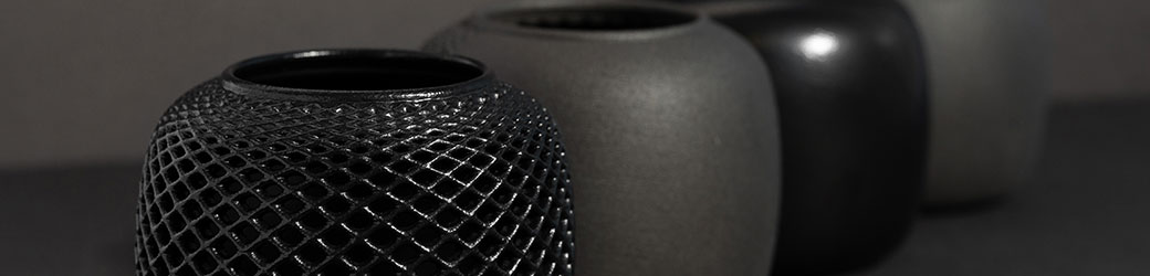

Real-World Examples of Plastic Design Challenges
Plastics can be used for a huge variety of applications and some of them can be surprisingly rugged, as you’ll see from these examples of companies that have worked with Protolabs’ factory services.
3D Printing: BrailleDoodle
For blind and low-vision kids, one of the most important things they can do is learn how to read Braille, but only 10% learn this critical skill. The TouchPad Pro Foundation set out to produce a functional, affordable prototype for a tablet designed to help these students learn Braille anywhere. Users can drag a magnetic stylus over its surface, pulling small metal balls in the holes to the surface in various patterns to create Braille letters, figures, or images. Plastic springs beneath the balls hold them firmly in place until the user pushes them down again. The design required 3,000 plastic springs to hold metallic balls in place at just the right tension.
With Protolabs, BrailleDoodle used ABS-like plastic and stereolithography (SLA) to build an affordable, accurate prototype that adhered to their exacting specifications. SLA was a sensible choice because of its high-resolution printing ability and fine surface finish, allowing the balls and springs to work as designed. Their engineers used design for additive manufacturing (DFAM) capabilities built into our quoting system to refine their designs in preparation for printing.
The nonprofit now has an impressive prototype to demonstrate at conventions and meetings. The Foundation has already received 500 orders for the product and plans to move to production soon.

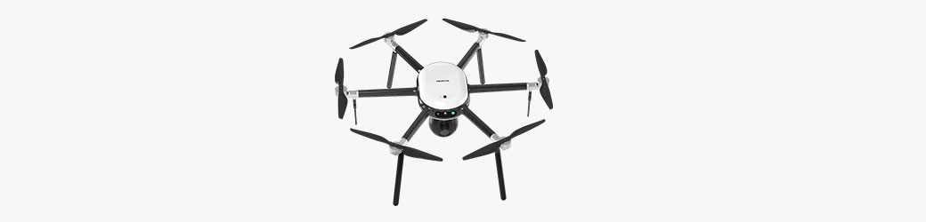

Injection Molding: Nokia
When it comes to drones, light-weighting components is critical. Plus, when it comes to security, technology and design must work together effortlessly to achieve the highest certification standards. Nokia came to Protolabs to build 19 different part designs for casing, structural elements, and a gasket to get their high-tech, enterprise-level surveillance system approved.
When working within the 5G cellular spectrum, antennas and other devices must be placed thoughtfully to avoid issues with signal attenuation. Metal parts can affect radio transmission and reduce signal quality, too, so plastic was the way to go. Plus, high-capacity batteries can pose a safety risk as they can be highly flammable. The choice of plastic and elements of design were part of those considerations. In the end, we used a particular polycarbonate thermoplastic to lessen weight and simplify molding. It’s strength and resistance to fracturing was perfect for this product.
The molded components not only protected the elements inside the drone and provided the necessary aerodynamics required for a high-performance unmanned aerial vehicle (UAV), but they were also intrinsic to the strength of the drone, ultimately holding the device together.

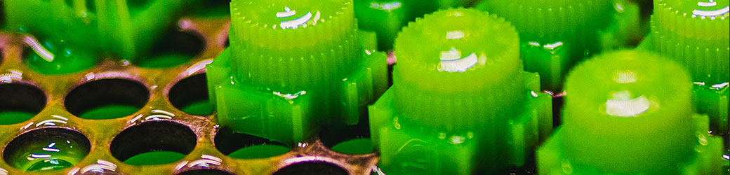

Future Trends and Developments
Because plastics manufacturing is always improving, what we see as trends here will likely go mainstream in record time. The future is now in terms of sustainability, design strategies, and manufacturing techniques.
Emergence of Bioplastics
A major focus across the manufacturing and product design world is how the industry can make plastics more environmentally friendly with innovation in bioplastics.
In general, for manufacturing, injection molding has been ahead of the curve when it comes to material variety and biocompatible plastics. A big reason for that is that injection molding is inherently production, rather than prototype driven. When the scientists and engineers developing these materials look at where these bioplastics can have the biggest impact, it’s in replacing traditional plastics produced at high volumes.
Also, there are different processing considerations with different manufacturing methods. There has been considerable effort put towards creating bioplastics that can run on existing injection molding equipment with minimally disruptive adjustments made to accommodate those materials. Unfortunately, those considerations change drastically when you start looking at producing a block of bioplastic material and expect it to withstand the strain of the CNC machining process. There’s an element of cost as well. Currently, bioplastics can be very expensive compared to the more mass-produced standard plastics and that cost affects both engineers who want to design bioplastic parts and the manufacturers considering working with those same materials.
While barriers exist for widespread adoption, the future looks bright. Every year there are new and exciting developments that make concepts like machining bioplastics more realistic and viable. Recently, a material sciences lab at the University of Washington used blue-green algae to create a new biocompatible material that is reportedly machinable, along with several other beneficial properties. We listen to where our customers want to go and bioplastic materials will only grow in popularity and demand as they become more proven, reliable, and ubiquitous.
Where is Plastics Manufacturing Heading?
In terms of plastics innovation, 3D printing is leading the way in exciting developments rapidly expanding its applications. The emergence of secondary processes that strengthen parts and improving aesthetics is one area of note. Vapor smoothing, for example, uses chemical vapors to eliminate roughness on certain SLS or MJF printed parts, resulting in a smooth, glossy finish like an injection molded part.
Light-weighting is another new direction for plastics manufacturing design. Combining the strength of certain plastics with strategic design can yield parts that require less material, less fuel for shipping, and other advantages. This is most prevalent in 3D printing, where the incorporation of lattice structures is producing stronger parts while shedding weight.
Automated quality control speeds validation and delivery of parts after manufacturing. The days of calipers are slowly ending as we see more robust versions of coordinate-measuring machines (CMM) introduced to the manufacturing floor. Increased automation in quality control is both producing better parts and allowing manufacturers to get those parts out the door faster.
Strategic nearshoring has become a popular way to avoid inventory shortages. Many companies are finding local or regional suppliers to handle their plastics manufacturing as an adjunct, or a replacement, for sending their work offshore. The sourcing strategy may have increased in popularity during the COVID-19 pandemic, but ongoing benefits may mean it is here to stay.
