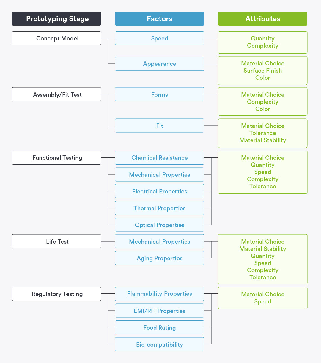

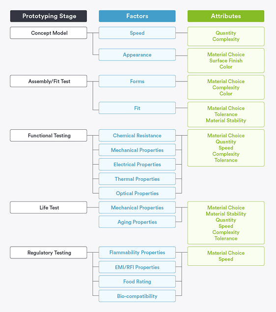

Choosing a Process
Use the decision tree below to narrow down which factors are of highest importance to you based on where you are in the prototyping process, referring as needed to the definitions below this decision tree infographic.
Rapid Prototyping Applications
Definitions vary and may differ at different organizations, but the definitions below may be used as a starting point.
Concept Model
A physical model made to demonstrate an idea. Concept models allow people from different functional areas to see the idea, stimulate thought and discussion, and drive acceptance or rejection.
Prototyping Considerations
  • Speed: turnaround time to convert a computer file into a physical prototype
  • Appearance: any visual attribute: color, texture, size, shape, etc.
Assembly/Fit Testing
Manufacturing some or all parts of an assembly, putting them together, and seeing if they fit properly. At the gross level, this checks for design errors, such as placing two tabs at 2 in. (50.8mm) spacing and the mating slots at 1 in. (25.4mm) spacing. At the fine level, this is a matter of minor dimensional differences and tolerances. Obviously, any test involving tolerances needs to use the actual manufacturing process or one which has similar tolerances.
  • Form: the shape of the part; features and size
  • Fit: how the part mates with other parts
Functional Testing
Evaluating how a part or assembly will function when subjected to stresses representative of what it will see in its actual application.
  • Chemical Resistance: resistance to chemicals including acids, bases, hydrocarbons, fuels, etc.
  • Mechanical Properties: strength of the part measured by tensile strength, compressive strength, flexural strength, impact strength, tear resistance, etc.
  • Electrical Properties: interaction of electrical fields with the part. This may include dielectric constant, dielectric strength, dissipation factor, surface and volume resistance, static decay, etc.
  • Thermal Properties: changes in mechanical properties that occur with changes in temperature. These may include thermal expansion coefficient, heat deflection temperature, Vicat softening point, etc.
  • Optical Properties: ability to transmit light. May include refractive index, transmittance, and haze.
Life Testing
Testing properties that may change with time and that are important for a product to remain functional throughout its expected life. Life testing often involves subjecting the product to extreme conditions (e.g., temperature, humidity, voltage, UV light, etc.) to estimate in a shorter period of time, how the product will react during its expected life.
  • Mechanical Properties (fatigue strength): ability to withstand repeated load cycles at various stress levels.
  • Aging Properties (UV, creep): ability to withstand exposure to ultraviolet light with an acceptable amount of degradation; ability to withstand extended applications of forces to the part with acceptable levels of permanent deflection.
Regulatory Testing
Testing specified by a regulatory or standards organization or agency to assure parts are suitable for a particular use such as a medical, food service, or consumer application. Examples include Underwriters Laboratory (UL), the Canadian Standards Association (CSA), the U.S. Food and Drug Agency (FDA), the U.S. Federal Communications Commission (FCC), the International Standard Organization (ISO) and the European Commission (EC).
  • Flammability Properties: the resistance of a resin or part to ignition in the presence of a flame.
  • EMI/RFI Properties: the ability of a resin, part or assembly to shield or block electromagnetic interference or radio frequency interference.
  • Food Rating: approval of a resin or part to be used in applications when it comes in contact with areas where food is prepared, served or consumed.
  • Biocompatibility: the ability of the resin or part to be in contact with human or animal bodies, outside or inside the body, without causing undue adverse effects (e.g., irritations, blood interactions, toxicity, etc.). Biocompatibility is important for surgical instruments and many medical devices.
