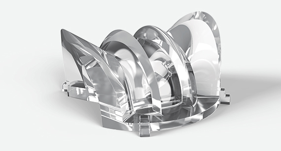

A clear automotive lens built by stereolithography.

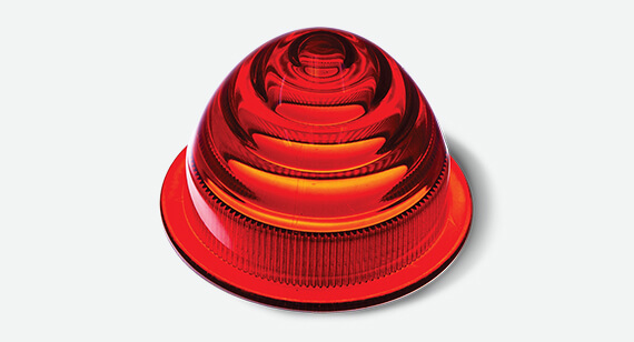

Liquid silicone rubber, or LSR, is a surprising but versatile material for many molding applications. It starts out as a two-part thermoset compound, which is mixed at low temperatures and then injected into a heated mold. Upon curing, LSR becomes strong yet flexible, and is suitable for gaskets, lenses, connectors, and other parts that require excellent thermal, chemical, and electrical resistance. Wiring harnesses, panel buttons, spark plug boots—these are but of few of the places LSR can be found in modern vehicles. That’s a lot of plastic. There are many more types available, and many can reduce the weight of products currently being made of steel or aluminum. A new material at Protolabs worthy of mention is CoolPoly, a unique polymer moldable in hardness levels ranging from Shore A 40 (soft like an eraser) to Shore D 80 (hard like a bowling ball). It was created as a replacement for heatsinks, lighting shrouds and other thermally conductive parts normally made of aluminum, reducing the weight of these components by 50-percent or more. This presents huge potential for lightweighting in electric vehicles, consumer electronics, lighting systems…the list goes on.

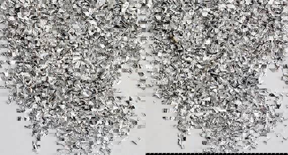

A growing method to rapidly manufacture magnesium parts is through injection molding (also known as thixomolding). Here, chips of magnesium feedstock are loaded into the hopper of a molding press. Heat and agitation are then applied, thus bringing the magnesium payload to a semisolid state, whereupon it is “shot” under pressure into a mold cavity via a feeder screw. The result is that fully functional magnesium components can be produced in low volumes at a fraction the cost of “production-tooled” parts.
Many manufacturing engineers associate magnesium with die casting, as this has long been the traditional, high-volume method of forming this ubiquitous metal. Yet magnesium injection molding offers a number of distinct advantages over its more mature counterpart. Thixomolding is essentially a “cold” process, operating just short of magnesium’s melting point. Because of this, there is less shrinkage and warp compared to die-cast parts, and the mechanical properties of thixomolded parts are generally better as well. The cooler process also requires less sophisticated tooling, as there is little need for cooling channels. And since the magnesium slurry is fed into the mold at very high pressure—in some cases twice that of die casting—very fine part details are produced. All things considered, thixomolding is a solid choice for low-volume magnesium components.
Another mature prototyping process is stereolithography (SLA), the grandfather of all 3D printing technologies. Protolabs uses SLA to print parts from nine grades of polymer across three primary groups: ABS, polycarbonate, and polypropylene. It’s important to point out that these materials mimic plastics and are not rated for functional product use. SLA does, however, produce highly accurate prototypes, and is a logical first step for an initial “touch and feel” of lightweighted concept parts. And for testing the form and fit of products destined for die casting, Protolabs offers SLArmor, a nickel-plated, ceramic-filled additive material that is very light yet still strong enough to pinch-hit for metal in certain cases, and an ideal solution for many lightweighting applications.

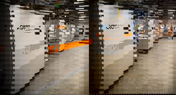

Another increasingly used additive manufacturing process offered is DMLS, or direct metal laser sintering. DMLS melts layers of metal powder, as thin as 0.0008 in. (20 microns) at Protolabs, to create complex, 98-percent dense part shapes that are often impossible to manufacture otherwise. It is highly accurate with tolerances of +/- 0.003 in. plus an additional 0.001 in./in. that are typically achieved on well-designed parts.
At Protolabs, DMLS works with aluminum and titanium, so is an obvious contender for manufacturing lightweight parts, but is also used with 316L and 17-4 PH stainless steel, cobalt chrome alloy, and Inconel, super strong metals known for their extreme heat resistance and durability rather than weight reduction. You might be wondering how an additive process that uses metals such as these has made its way into a lightweighting white paper. But here’s the thing: DMLS can fabricate metal parts that, until now, were nothing more than a designer’s fantasy. Parts more hollow than a chocolate Easter egg, Escher-like curves and spheres, ultra-thin walls, and spider web-like lattices, consolidation of multipart assemblies into a single sintered component—these are a few of the lightweighting possibilities DMLS (as well as SL and SLS) can offer.
DMLS is slower than other additive processes, and more expensive—if your part design can be efficiently machined or molded, DMLS may not be the right manufacturing method. But for complex assemblies, improbable shapes, or parts where small amounts of superalloy go a long way, DMLS might be just the ticket to reduce part weight and cut manufacturing costs. Lastly, DMLS isn’t limited to prototype quantities—given a small, complex workpiece too difficult or expensive to manufacture via conventional methods, DMLS is often a viable alternative for low-volume production volumes in the thousands.
