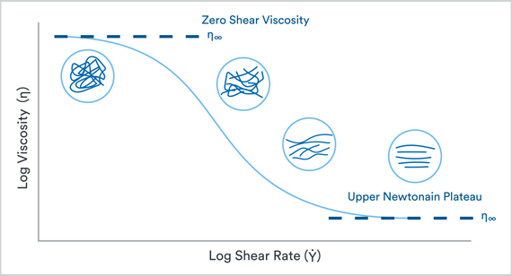

As the material is being driven to flow, shear stress is imparted on the molecular chains. The shear stress begins to align the molecular chains in the direction of flow, thus allowing the chains to slip more easily past one another. As a result, as shear rate is increased, the easier the material will flow (viscosity drops).
This is a behavior seen with Non-Newtonian fluids. The viscosity will continue to drop as shear rate is increased until the molecular chains have reached full alignment. At the point of full alignment, the viscosity will remain constant with further increasing shear rate. This is known as the Upper Newtonian Plateau, as the material will now exhibit a more Newtonian fluid type of behavior [see Viscosity Change vs. Shear Rate chart above].

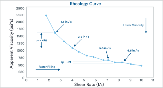

Let’s move from background to application. The fill-speed determination process attempts to capture this shear-thinning behavior of the material as it flows through the mold. The in-mold rheology curve plots apparent viscosity vs. shear rate using readouts from the press—actual injection pressure and actual fill time [see Rheology Curve chart below].
As seen in the Rheology Curve chart, as the shear rate is increased, the viscosity is reduced. At higher shear rates, the viscosity begins to level off. Choosing a fill speed that results in a shear rate in this plateaued region allows for material differences from lot to lot. Additionally at this fill speed, inconsistencies in the machine stroke speed/response will have a negligible effect on the viscosity of the material that is flowing into the mold cavity. This results in manufactured parts having more uniform molecular/filler orientation, heat history, and pressurization from shot to shot.
Looking at the process for determining a robust fill-speed setting also allows for the molding process to use the shear-thinning behavior of polymers to fill out smaller features, more accurately replicate mold geometry, improve weld line strength, and minimize potential for flow front hesitation. Be cautious, though: Don’t choose a fill speed that is too fast, resulting in very high shear rates. Shear rates that are too high can begin to degrade the polymer. The molecular chains can begin to break down, resulting in lower molecular weight. Lower molecular weight chains result in mechanical properties of the material being altered. This can lead to premature part failure. High shear rates are especially damaging to filled materials. Glass-fiber is a very common reinforcement for plastic materials, and often times has a shear rate limit well below that of the carrier material. When shear rates are too high, reinforcing fibers can be broken down, thus reducing their effectiveness.

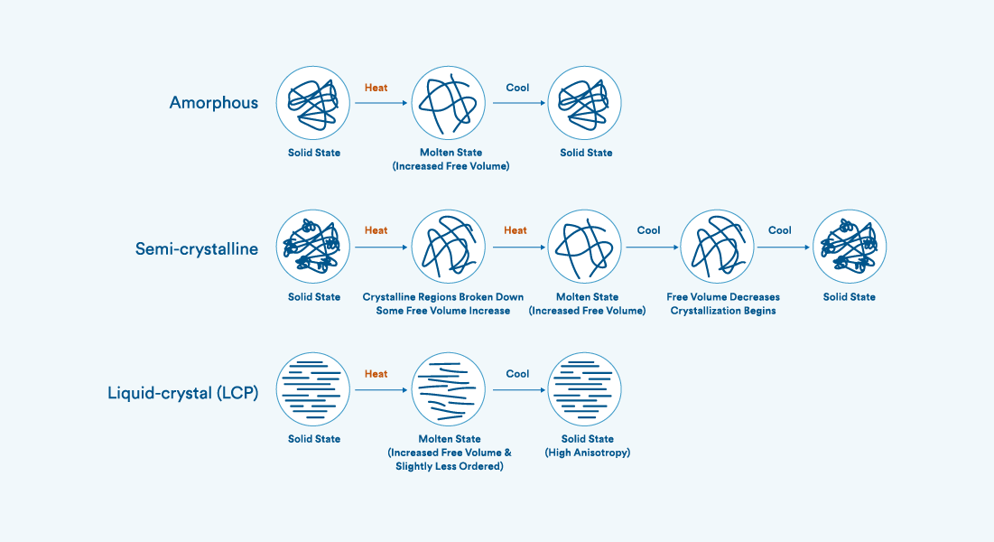

When plastic melt enters the mold cavity, it is at a lower density than when the polymer is solidified. As the plastic cools, the free volume between the molecular chains reduces. The illustration on page 5. highlights the state changes that occur with amorphous, semi-crystalline, and liquid-crystal polymers.
If the material is a semi-crystalline, portions of the chains can form highly ordered regions known as lamellae. These lamellae make up the crystalline regions known as spherulites. These regions exhibit relatively high local densities. The reduction of free volume, and the possible formation of crystalline regions, results in shrinkage of the overall melt volume.
This illustration highlights the changes that occur with amorphous, semi-crystalline, and liquid-crystal polymers.

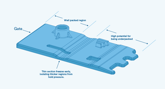

As plastic cannot effectively transfer pressure once it is solidified, the amount of time for effective packing becomes geometry-dependent. As previously discussed, thin sections within the part can freeze off quicker than thick sections and isolate regions from packing pressure.
Following standard practices for injection molding part and mold design, it is common that gates will be placed in an area that allows for thick to thin packing, and the gates are typically sized as a percentage of the wall thickness being gated into.
Common gate sizes typically range from 60% to 80% of the wall thickness, but certain gate designs require more restrictive sizes to facilitate separation from the part wall.
Given that the gate is typically thinner than the part wall, the gate will solidify before the part geometry. Once the gate is solidified, pressurization of the part cavity from the feed system is complete.

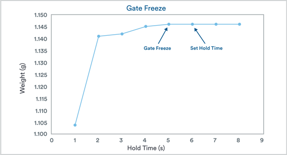

Gate freeze determination involves tracking the weight of the part when different hold times are used. As long as the gate is open, and the cavities continue to be packed, the part weights will continue to increase.
Once part weights reach a stable level, it can be inferred that the gate has frozen, and the parts are no longer being packed. The hold time where the weights have leveled off can be considered the time for gate freeze.
Typically a buffer of one to two seconds is added to the hold time setting to ensure that the gate is frozen regardless of any inherent variation within the material or machine.
In the Gate Freeze chart, it can be seen that the part weight continued to increase as more hold time was used. As the gate began to solidify to a larger extent, the rate of weight gain begins to slow.
In this example, five seconds is the first point where the weight has stabilized. This indicates that the gate has frozen somewhere between four and five seconds, and a one-second buffer has been added to ensure process robustness.
