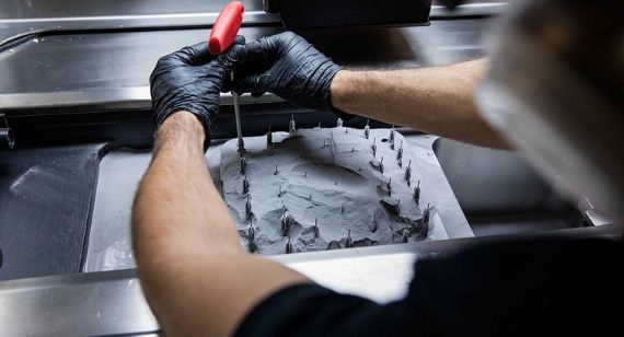

3D-printed parts
Direct metal laser sintering (DMLS) is one of six additive manufacturing processes available at Protolabs.
Material suppliers rarely publish material specifications that document the change in properties from one axis to another, as the data behind these specifications can vary greatly by material, process, and even type of machine. By designing for the additive manufacturing (DfAM) process and adjusting the build orientation, anisotropism or inadequate material properties can be overcome. To do this, leverage the experiences from past projects or that of a qualified service organization to fill any gaps that arise because of limited material property data.
Outlined in this guide, you will find AM material data that is based on internal testing of additive materials built and post-processed using our capabilities here at Protolabs. Of note, all of the figures contained in this document are approximate and dependent on a number of factors, including but not limited to, machine and process parameters. Therefore, the information provided is not binding and not deemed to be certified.
When performance is critical, also consider independent lab testing of additive materials or final parts. While AM part success is dependent on material properties, they are not the only considerations. Each additive material and build process will also dictate characteristics such as dimensional accuracy, feature resolution, surface finish, production time, and part cost. So it is advised to select a suitable material and then evaluate its ability to meet expectations and requirements related to performance, cost, and quality.

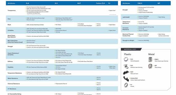

Material Selection for 3D Printing
Since 3D printing is unique, a goal of finding a perfect match to a cast, molded, or machined material is ill-advised. Within this guide, you’ll see some charted comparisons to traditional manufacturing methods that are intended to help level set AM material expectations for certain mechanical or physical properties.
Generally, one or two material properties distinguish an additive material from all others. Recognizing that a few properties will separate one material from the others, the recommended approach for selecting a material for 3D printing is to first define what mechanical or physical properties are key and identify critical-to-quality features. Then review the material and manufacturing options to find a fit based on your timeline and end-use goal.

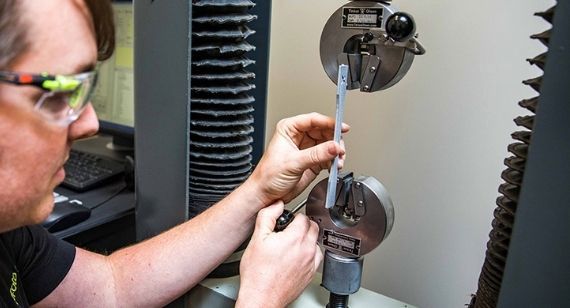

Testing method 3D printing
A variety of material properties are tested in 3D printing processes, including ultimate tensile strength, elongation, hardness, and more.
3D Printing Materials: Definitions and Test Methods
Let’s take a minute to define some key terms you will see throughout this guide.
Ultimate tensile strength (UTS) refers to the maximum stress the material can withstand before breaking.
Tensile modulus, or elastic modulus, refers to the material stiffness. The higher the modulus, the stiffer the material.
Elongation (%) refers to the ductility of the material. Think about stretching a material into a wire. A higher elongation % indicates a material is more likely to be able to stretch or elongate into a thin wire shape.
Hardness is measured and reported in HRC or HRB on the Rockwell scale for metals within this guide. For polymers, like PJ, durometers are reported. The higher the number, the harder the material.
Heat Deflection Temperature (HDT), sometimes called heat distortion temperature, is the temperature at which deformation occurs when a rigid material is placed under a specific load.
For the purposes of this guide, plastic 3D-printed materials were analyzed for heat deflection per ASTM D648 with the exception of TPU. Internal testing for TPU 70-A was performed per ASTM D412. HDT values were measured at 66 psi. ASTM D648 was leveraged to perform internal testing on 3D-printed samples off of our machines. 3D-printed samples were pulled at a rate of 10 mm/min. X-Y plane samples were manufactured in a flat position parallel to the build platform or within the powder bed. Z plane samples were manufactured in an upright position. All DMLS sample bars were manufactured and tested in the Z plane, normal to the build platform.

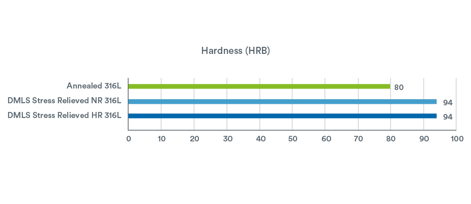

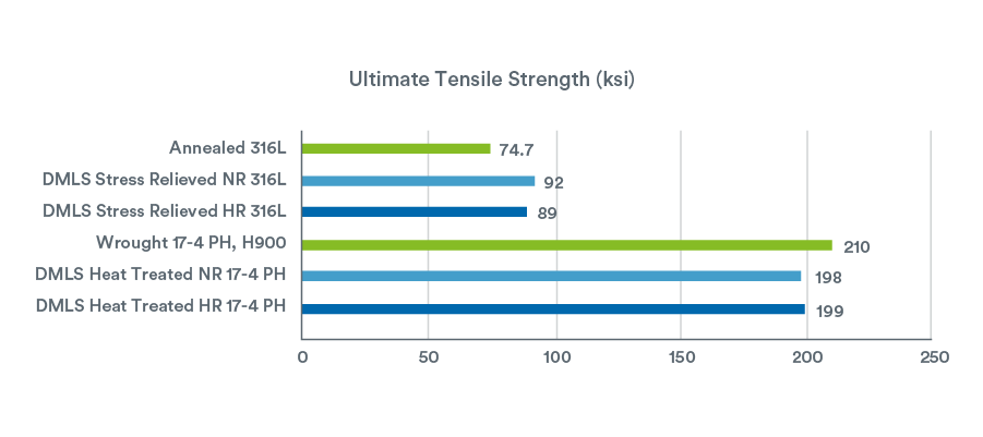

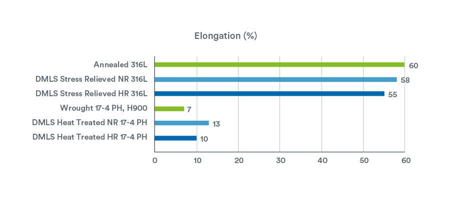

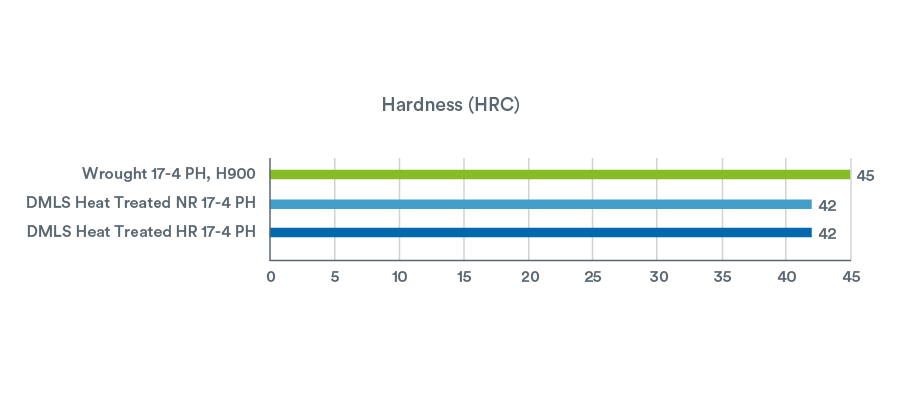

Comparing Workhorse Materials: 17-4 PH vs. 316L
Stainless steel is a commonly used DMLS material, and it is available in two grades here at Protolabs: 17-4 PH and 316L. Select 17-4 PH (precipitation hardened) for its significantly higher tensile strength and yield strength, but recognize that it has less elongation at break than 316L, which means that 17-4 is less malleable than 316L. If you need a steel part with some flexibility, go with 316L. Both 17-4 PH and 316L are corrosion resistant options, but 316L is better at resisting acids. Note that 17-4 may be heat treated with a vacuum solution heat treatment and an H900 aging heat treatment to improve mechanical properties, while 316L is only offered in the stress-relieved state. As with all DMLS materials we offer, both of these stainless steels can be machined after they are printed. The order of heat treatments and any post-processing work may be interchanged on 17-4 parts depending on machining requirements.
Note that DMLS 17-4 PH and 316L share comparable mechanical and physical properties to their non-AM wrought counterparts.
Stainless Steel: Material Properties Compared
Grade Heat Treatment Ultimate Tensile Strength Elongation Hardness
316L Annealed 74.7 ksi 60% 80 HRB
DMLS NR 316L Stress Relieved 92 ksi 58% 94 HRB
DMLS HR 316L Stress Relieved 89 ksi 55% 94 HRB
Wrought 17-4 PH H900 210 ksi 7% 45 HRC
DMLS NR 17-4 PH Heat Treated 198 ksi 13% 42 HRC
DMLS HR 17-4 PH Heat Treated 199 ksi 10% 42 HRC

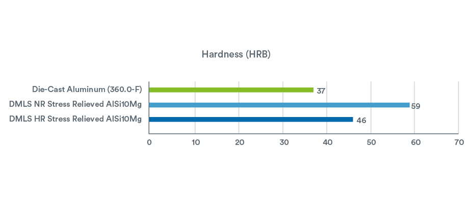

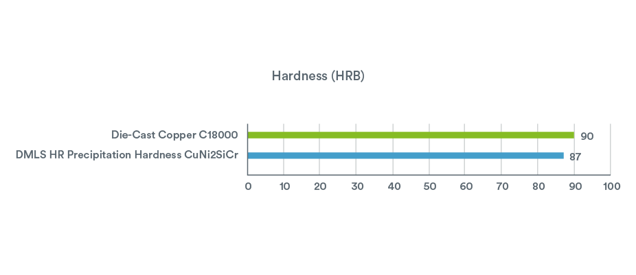

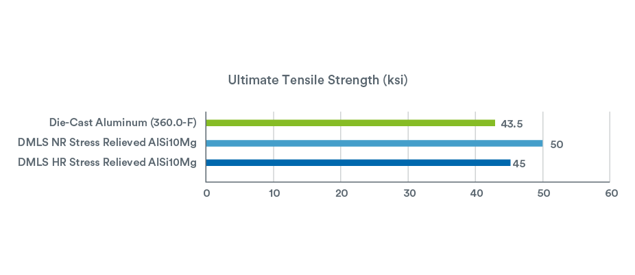

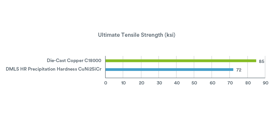

Conductive Metal Options

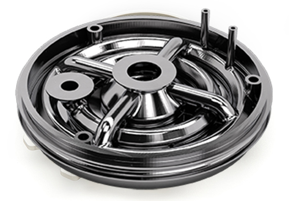

Aluminum AlSi10Mg is comparable to a 360.0F aluminum alloy that is used for die cast processes. AlSi10Mg has good strength-to-weight ratio, high temperature and corrosion resistance, and good fatigue, creep, and rupture strength. AlSi10Mg also exhibits thermal and electrical conductivity properties. Compared to die-cast aluminum, the properties for tensile strength are comparable. However, elongation at break is slightly higher when compared to the average for aluminum. At Protolabs, our internal testing shows that AlSi10Mg built in NR (30 micron layers) exhibits a higher HRB value when compared to high resolution AM or cast aluminum.
Metal plating is another manufacturing modality to keep in mind. When prototyping parts that would normally be die cast or machined from aluminum, magnesium, or zinc, consider metal plating as an option. We offer a PC-like SLA resin that can be metal plated. The core material is a ceramic-like (Advanced High Temp) composite SLA material that exhibits strength, stiffness, and temperature resistance. After SLA parts are built, they are electroplated with a prescribed thickness of structural copper and nickel. To ensure dimensionality of the parts is maintained, software is used to adjust the SLA components prior to their manufacture to account for the targeted plating thickness. Metal-plated components can withstand high temperatures, abrasion, and highly corrosive environments.
Aluminum: Material Properties Compared
Grade Heat Treatment Ultimate Tensile Strength Hardness
Die-Cast Aluminum (360.0-F) n/a 43.5 ksi 37 HRB
DMLS NR AlSi10Mg Stress Relieved 50 ksi 59 HRB
DMLS HR AlSi10Mg Stress Relieved 48 ksi 46 HRB

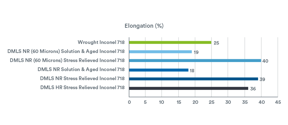

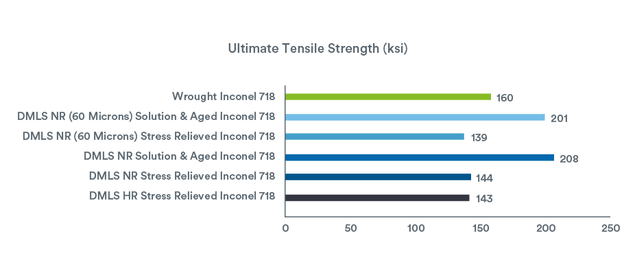

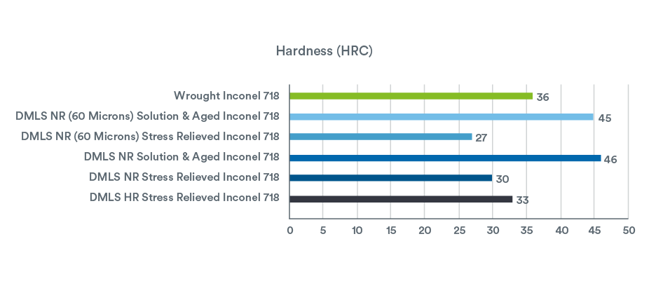

Superalloys
Inconel 718 is a nickel chromium superalloy used in a vast range of temperature applications (-423 degrees F-1,300 degrees F) such as high-heat aircraft engine components and low-temperature cryogenic applications. Its high-temperature strength is derived from its ability to create a thick, stable, passivating oxide layer at high temperatures. Inconel 718 also has good tensile, fatigue, creep, and rupture strength properties.
When solution-treated and aged per AMS 5663, Inconel 718 exhibits higher tensile strength and increased hardness, coupled with a reduction in elongation %. Inconel 718 parts as large as 31.5 in. x 15.7 in. x 19.7 in. (800mm x 400mm x 500mm) in size can be manufactured here at Protolabs in 60 micron layers.
Inconel 718: Material Properties Compared
Grade Heat Treatment Ultimate Tensile Strength  Hardness Elongation
Wrought Inconel 718 n/a 160 ksi 36 HRC 25%
DMLS NR (60 Microns) Inconel 718 Solution & Aged 201 ksi 45 HRC 19%
DMLS NR (60 Microns) Inconel 718 Stress Relieved 139 ksi 27 HRC 40%
DMLS NR Inconel 718 Solution & Aged 208 ksi 46 HRC 18%
DMLS NR Inconel 718 Stress Relieved 144 ksi 30 HRC 39%
DMLS HR Inconel 718 Stress Relieved 143 ksi 33 HRC 36%

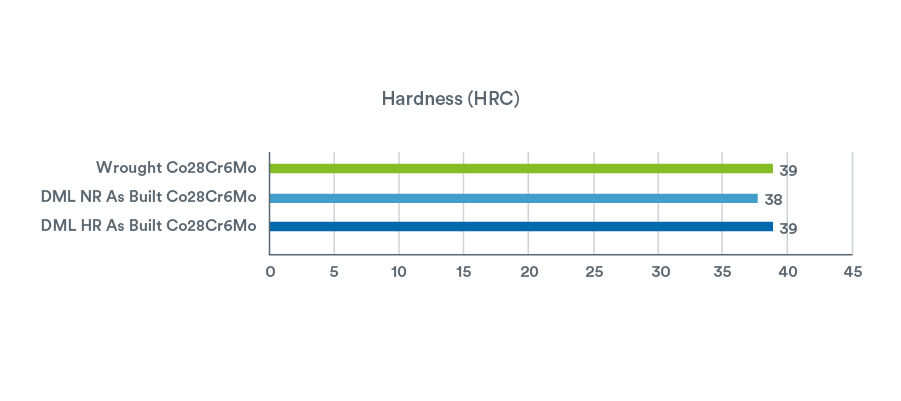

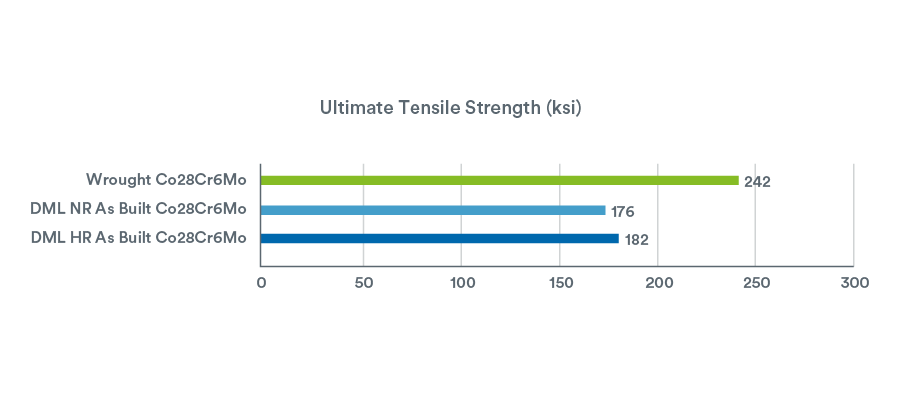

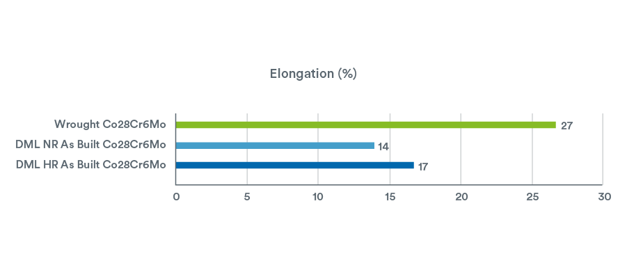

A Superalloy for Specialty Applications
Cobalt chrome (Co28Cr6Mo) is another DMLS superalloy that is used for specialty applications within the aerospace and medical industries because of its strength-to-weight ratio, creep, and corrosion resistance properties. DMLS Co28Cr6Mo, as defined by ASTM F75, hardness values are in line with wrought Co28Cr6Mo, but ultimate tensile strength and elongation are not as closely aligned.
Note that if these DMLS Co28Cr6Mo samples received heat treatment, this separation would not be as notable.
Cobalt Chrome: Material Properties Compared
Wrought Co28Cr6Mo n/a 242 ksi 39 HRC 27%
DMLS NR Co28Cr6Mo As Built 176 ksi 38 HRC 14%
DMLS HR Co28Cr6Mo As Built 182 ksi 39 HRC 17%

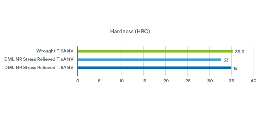

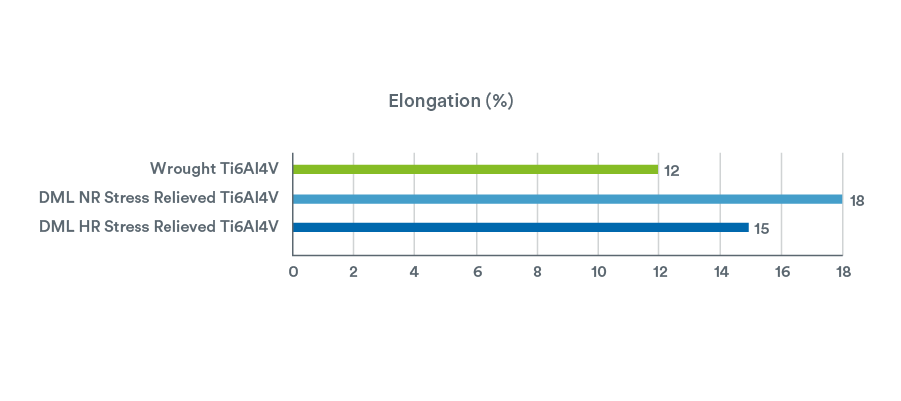

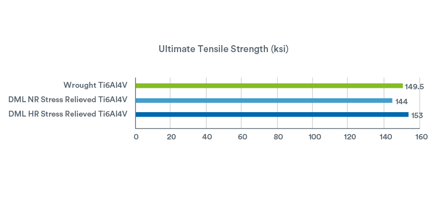

Strong as Steel, but Lightweight
Titanium Ti6Al4V, similar to DMLS cobalt chrome, is most commonly used for aerospace and medical applications due to its strength-to-weight ratio, temperature resistance, and acid/corrosion resistance.
Compared to wrought Ti6Al4V, the mechanical properties of vacuum stress relieved Ti6Al4V are similar to wrought titanium for tensile strength, elongation, and hardness.
Titanium: Material Properties Compared
Wrought Ti6Al4V n/a 149.5 ksi 35.3 HRC 12%
DMLS NR Ti6Al4V Stress Relieved 144 ksi 33 HRC 18%
DMLS HR Ti6Al4V Stress Relieved 153 ksi 15 HRC 15%

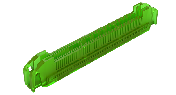

MicroFine™ is a custom material exclusive to Protolabs.
MicroFine™ is a custom-formulated material available in gray and green that is exclusive to Protolabs. This ABS-like material is 3D-printed in our customized machinery to achieve high resolution features as small as 0.0025 in. (0.0635mm) MicroFine is ideal for small parts, generally less than 1 cubic inch. In terms of mechanical properties, MicroFine falls in the mid-range of SLA materials for tensile strength and modulus and on the low end for impact strength and elongation.

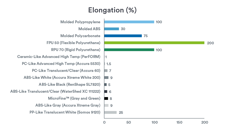

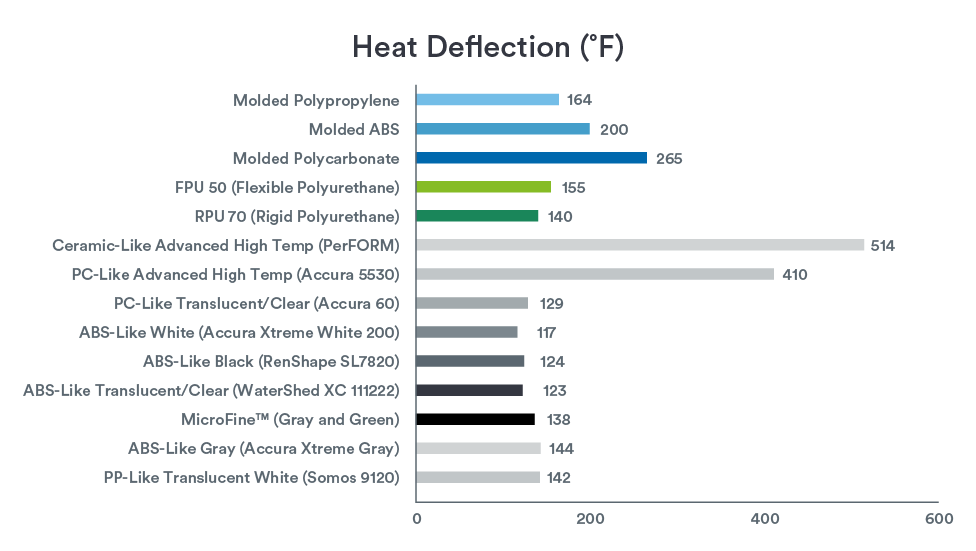

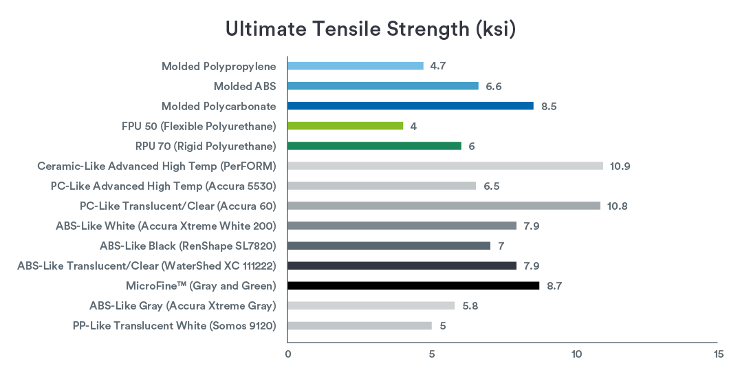

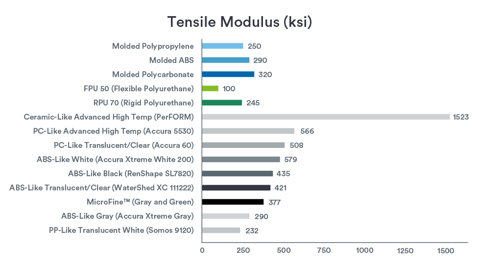

SLA & Carbon DLS Material Comparison Charts
  Tensile Strength Elongation Tensile Modulus Heat Deflection
Molded Polypropylene 4.7 ksi 100% 250 ksi 164F
Molded ABS 6.6 ksi 30% 290 ksi 200F
Molded Polycarbonate 8.6 ksi 75% 320 ksi 265F
FPU 50 (Flexible Polyurethane) 4 ksi 200% 100 ksi 155F
RPU 70 (Rigid Polyurethane) 6 ksi 100% 245 ksi 140F
Ceramic-Like Advanced High Temp (PerFORM) 10.9 ksi 1% 1,523 ksi 514F
PC-Like Advanced High Temp (Accura 5530) 6.5 ksi 1.5% 566 ksi 410F
PC-Like Translucent/Clear (Accura 60) 10.8 ksi 7% 508 ksi 129F
ABS-Like White (Accure Xtreme White 200) 7.9 ksi 9% 579 ksi 117F
ABS-Like Black (RenShape SL7820) 7 ksi 5% 435 ksi 124F
ABS-Like Translucent/Clear (WaterShed XC 111222) 7.9 ksi 6% 421 ksi 123F
MicroFineTM (Gray and Green) 8.7 ksi 8% 377 ksi 138F
ABS-Like Gray (Accura Xtreme Gray) 5.8 ksi 9% 290 ksi 144F
PP-Like Translucent White (Somos 9120) 5 ksi 25% 232 ksi 142F

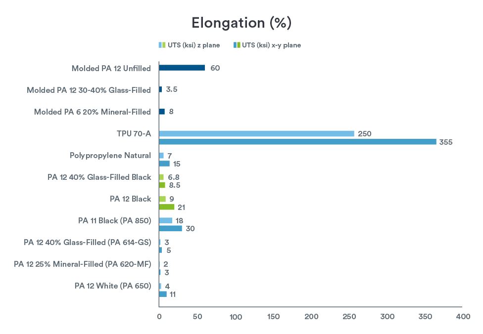

Selective Laser Sintering (SLS) & Multi Jet Fusion (MJF) Materials
Selective laser sintering and Multi Jet Fusion offer the most economical AM material choices. The SLS/MJF technologies use thermoplastic powder forms, predominantly polyamide (PA), to make functional parts that have greater toughness and higher impact strengths compared to SLA parts. SLS/MJF materials also offer high HDTs ranging from 315 degrees F to 370 degrees F (measured at 66 psi). SLS/MJF parts are durable and able to withstand wear and abrasion for functional testing. They can produce parts with flexibility, such as living hinges or snap features.
The density of SLS/MJF materials is close to that of traditionally manufactured parts. One added benefit of this technology is that no support structures are required when sintering and fusing the parts. If large parts are needed, SLS parts as large as 19 in. (482.6mm) x 19 in. (482.6mm) x 17 in. (431.8mm) can be manufactured. SLS/MJF parts do lack in providing the surface finish and fine feature details available with SLA. However, when going head to head, MJF slightly outperforms SLS when it comes to manufacturing fine feature details.
Generally, PAs, when compared to the average values of their injection-molded counterparts, have similar HDT values butlower mechanical properties. SLS/MJF material properties have a known degree of anisotropism when measured in the x-y plane or the z plane. Values reported in this guide account for both measurements.
General Purpose Nylons
PA 11 Black (PA 850) delivers ductility and flexibility without sacrificing tensile strength and temperature resistance. These characteristics make PA 850 a popular general-purpose material. Its EB is the highest of all AM nylons. Another factor that distinguishes PA 850 is its uniform, deep-black color. Black has high contrast, which makes features pop, and it hides dirt, grease, and grime. Black is also desirable for optical applications due to its low reflectivity.
PA 12 White (PA 650) is another go-to material for general-purpose applications. PA 650 is the strongest of the unfilled nylon materials. It is stiffer than PA 850 with a slightly higher elastic modulus and has comparable tensile properties when measured in the x-y and z directions. While its EB is less than half that of PA 850, it’s still one of the top performers in terms of ductility among the SLS PA materials.
PA 12 Black is a high tensile strength nylon manufactured using MJF. Final parts are dyed black, and they exhibit quality surface finishes and slightly more isotropic mechanical properties when compared to SLS. When more detail is required, this material can achieve smaller minimum feature resolution—0.02 in. (0.508mm)—as compared to SLS materials—0.03 in (0.762mm). PA 12 Black is the best material option for designs that incorporate living hinges.
Filled Materials
PA12 Mineral-Filled (PA620-MF) is a 25% mineral fiber-filled PA powder. The fiber content significantly increases stiffness and HDT. It is a good material option when stiffness and high temperature resistance are important requirements. Due to the sintering process, fiber origination effects (i.e. differing mechanical properties based on fiber alignment and orientation) that can occur in injection-molded parts are largely eliminated with printed parts that use sintering-filled materials.
PA12 40% Glass-Filled (PA614-GS) is another PA powder loaded with glass spheres that make it stiff and dimensionally stable. This material is an ideal candidate for parts that require long-term wear resistance properties. Due to the glass additive, it has decreased impact and tensile strengths compared to other nylons. At 315 degrees F, PA614-GS has the lowest HDT of the AM nylons.
PA 12 40% Glass-Filled Black is another option if you are looking to use a filled MJF material. The biggest advantage offered by this material is the heat deflection temperature of 248 degrees F (120 degrees C) when measured at 264 psi, ranking second best after PA 12 Mineral-Filled.
Specialty Materials
TPU 70-A is a thermoplastic polyurethane that combines rubber-like elasticity and elongation with good abrasion and impact resistance properties. The rubber-like quality of this material makes it ideal for seals, gaskets, grips, hoses, or any other application where excellent resistance under dynamic loading is required. This specialty material is the second-most flexible AM material at Protolabs behind the softest (Shore 30A) PJ material offered.
Polypropylene Natural offers chemical resistance properties that are top among the SLS and MJF material offerings. This material is a true polypropylene, not a polypropylene-like material. This tough and durable, yet flexible, material offers resistance to most acids and is a low-weight material option.

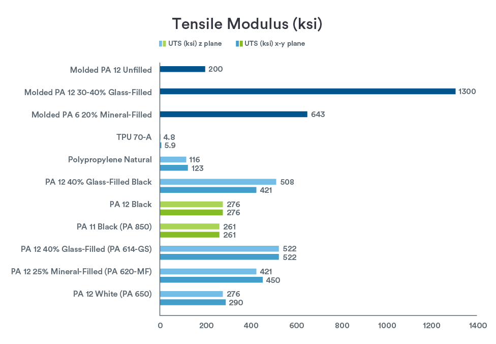

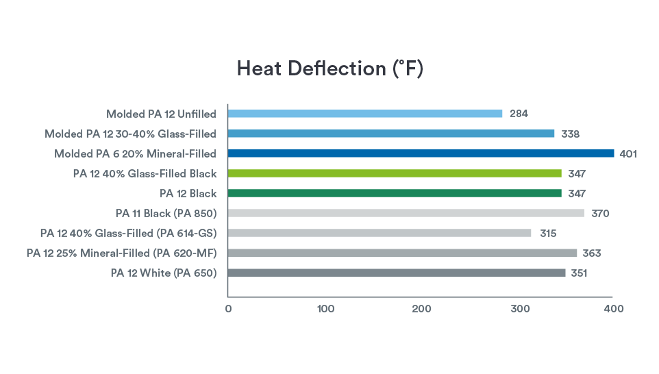

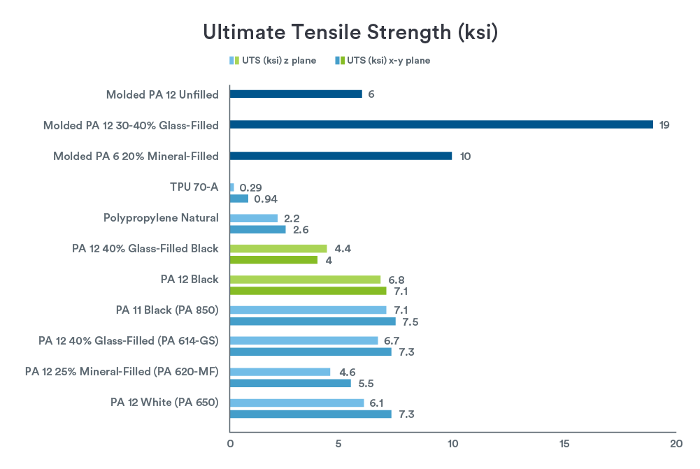

SLS & MJF Material Comparison Charts
Molded PA 12 Unfilled 6 ksi 60% 200 ksi 284o F
Molded PA 12 30-40% Glass-Filled 19 ksi 3.5% 1,300 ksi 338o F
Molded PA 6 20% Mineral-Filled 10 ksi 8% 643 ksi 401o F
TPU 70-A X-Y Plane 0.29 ksi 250% 4.8 ksi n/a
Z Plane 0.94 ksi 355% 5.9 ksi
Polypropylene Natural X-Y Plane 2.2 ksi 7% 116 ksi n/a
Z Plane 2.6 ksi 15% 123 ksi
PA 12 40% Glass-Filled Black X-Y Plane 4.4 ksi 6.8% 508 ksi 347o F
Z Plane 4 ksi 8.5% 421 ksi
PA 12 Black X-Y Plane 6.8 ksi 9% 276 ksi 347o F
Z Plane 7.1 ksi 21% 276 ksi
PA 11 Black (PA 850) X-Y Plane 7.1 ksi 18% 261 ksi 370o F
Z Plane 7.5 ksi 30% 261 ksi
PA 12 40% Glass-Filled (PA 614-GS) X-Y Plane 6.7 ksi 3% 522 ksi 315o F
Z Plane 7.3 ksi 5% 522 ksi
PA 12 25% Mineral-Filled (PA 620-MF) X-Y Plane 4.6 ksi 2% 421 ksi 363o F
Z Plane 5.5 ksi 3% 450 ksi
PA 12 White (PA 650) X-Y Plane 6.1 ksi 4% 276 ksi 351o F
Z Plane 7.3 ksi 11% 290 ksi

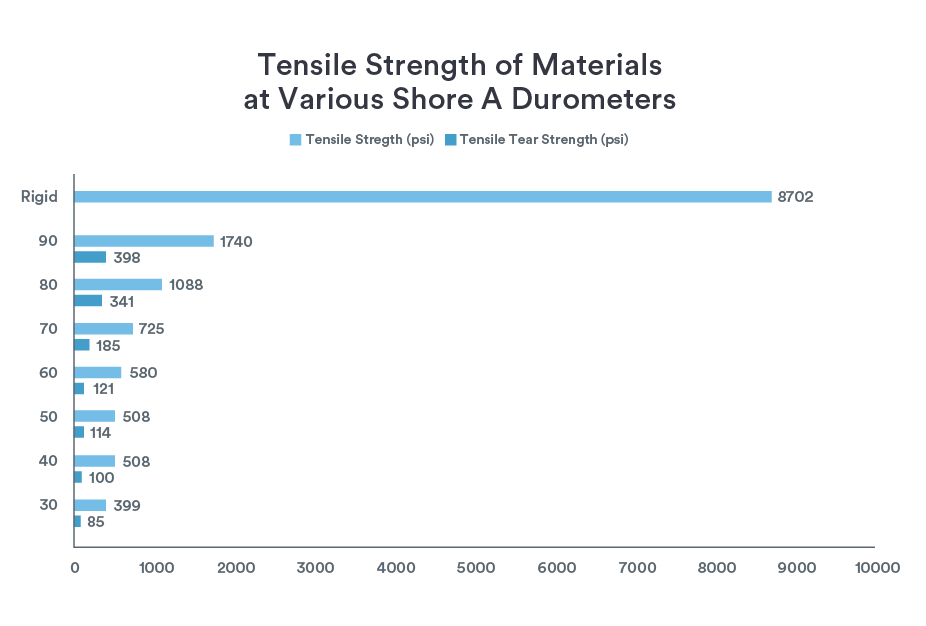

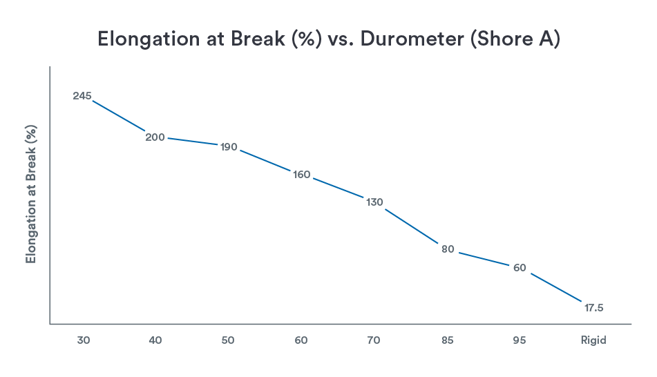

PolyJet (PJ) Materials
Digital photopolymer parts are achieved with the PolyJet (PJ) printing process. PJ materials are available in multiple Shore A hardnesses and colors: clear/translucent, white, and black. Parts can even be printed with two-tone coloring aesthetics and ranges of durometers.
Digital photopolymers can be leveraged in a variety of 3D printing applications that incorporate flexible features. PJ materials are routinely used to prototype overmolded and liquid silicone rubber (LSR) parts such as: gaskets, seals, covers, and straps.
While digital photopolymer does mimic some mechanical properties of LSR there are inherent differences that result in altered behavior. One fundamental difference of the materials is viscoelastic creep. Creep is a change in strain as a function of time while the stress remains constant. We tested injection-molded LSR samples against our PolyJet materials for viscoelastic creep at both 60A and 30A durometer. The PolyJet materials show a high initial value before quickly dropping below the specified hardness. LSR showed slight drift at the beginning of the test but quickly leveled out to a consistent value that was unaffected by time. It is worth understanding these material differences if you are leveraging digital photopolymer as an LSR prototype material.
PolyJet Materials Charts
Shore A Durometer Tensile Strength Tensile Tear Strength Elongation
30A 399 psi 85 psi 245%
40A 508 psi 100 psi 200%
50A 508 psi 114 psi 190%
60A 580 psi 121 psi 160%
70A 725 psi 185 psi 130%
80A 1,088 psi 341 psi 80%
95A 1,740 psi 398 psi 60%
