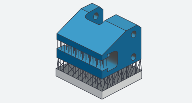

This drawing of the part rendered above reveals the difficulty of designing tall walls and other special features using 3D printing.
Small gaps in features also pose difficulties for 3D printing. Plastic is affected by gravity and wants to sag or warp, given the chance. While these features are possible, check with us if you are concerned about your CAD model's DFAM-worthiness.

Self-supporting angles
Building a part layer-by-layer requires that you consider the law of gravity in your design. Heavy areas tend to sag and warp as parts are built, so you want to ensure that any feature can support its own weight during the build by using smooth transitions to control potential sag.
Metal 3D printing has its own set of design issues, yet one common item that emerges involves overhangs. Different from self-supporting angles that offer a smooth slope to a part design, overhangs are abrupt changes in a part’s geometry. DMLS is fairly limited in its support of overhangs when compared to other 3D printing technologies like SLA and SLS. Any overhang greater than 0.020 in. (0.5mm) should have additional support to prevent damage to the part during the build. When designing overhangs, it is wise to not push the limits as large ones can cause a reduction in a part’s detail or worse, lead to the whole build crashing.
