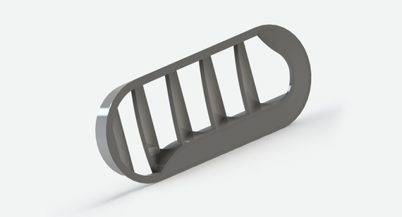

Switching the grill to Protolabs’ injection molding process brought immediate quality improvements, Hasson said, noting that the resulting parts were more consistent. A better surface finish meant the injection-molded grill needed less finish work before custom painting. The grill, made of ABS plastic, was much stronger, eliminating issues with breakage of the more brittle cast urethane part.

Beyond injection molding, Sea Ray also took advantage of Protolabs’ industrial-grade 3D printing service, Hasson said. Sea Ray, after submitting a CAD file through Protolabs’ online quoting system, had the rapid manufacturer build two or three D-printed iterations of the grill for testing as it worked through design revisions. Once a final design was in hand, some of the 3D-printed grills served as production parts, going on the L650 Fly until the injection-molded ones were ready.

The speed at which injection-molded and 3D-printed parts came from Protolabs has helped during design of the grill and in production, Hasson said. Molded grill parts were available in three weeks, “which in traditional injection molding is unheard of,” he said. 3D-printed parts shipped in four days.
