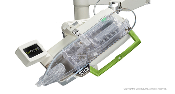

![CorPath GRX Robotic System with components manufactured at Protolabs](/media/1020884/corindus-adjustable-arm-570x308.jpg?width=570&height=308&rnd=132403147287700000)
At the same time, Falb said, he and his colleagues initially considered using machining or 3D printing for prototyping parts. “But we learned that we would need to make hundreds if not thousands of parts.” Machining in this case was too expensive. Additionally, 3D printing would be very costly and 3D printing would not provide the part quality and precision needed.

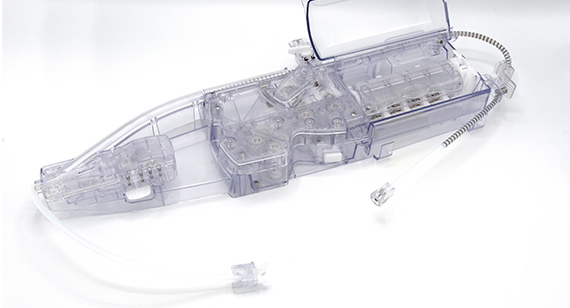

![single use cassette for CorPath manufactured at Protolabs](/media/1020886/corindus-studiosession-007-edit-570x308.jpg?width=570&height=308&rnd=132403147292930000)
Solution: On-Demand Manufacturing
We offered an on-demand manufacturing approach for Corindus with injection molding that could rapidly produce the parts for the cassette. Injection molding was also an affordable manufacturing alternative available in lower volumes than traditional mass production. This helped mitigate financial risk that comes with large capital investments in production steel tooling. And, our approach could allow for rapid tooling and parts production and solve demand uncertainty because parts could be produced on demand.
“The ability to make tools [molds] fast, to make parts fast, being able to have support in low-volume [quantities] at a reasonable capital cost—these were the pieces we were looking for,” said Tarca.
Speed was paramount. With dozens of parts and in some cases multiple iterations, molds and parts were still delivered fast, recalled Gary Kappel, principal mechanical design engineer for Corindus. How fast? “Think weeks instead of months. By comparison, if we would have used a traditional manufacturer, it would have been substantially longer…speed, low cost, and quality were the strongest points here,” especially as they raced to meet various pivotal verification deadlines such as FDA evaluations.
Falb agreed. “Had we gone with prototype tooling with other vendors, there’s no way it would have been that quick—the Protolabs software interface with design analysis, is very clear, intuitive, and very helpful to get the design details right for moldability ….it works really well.”
Beyond speed, manufacturing in low volumes was a need. Kappel said our injection molding tooling and part costs proved to be quite affordable in low volumes. “Protolabs made many injection-molded parts for us in prototyping and right now Protolabs is making 30 to 40 specific, end-use parts in production volumes for us.” He estimated the part numbers produced are now in the tens of thousands, for both first and second generations of the cassette.

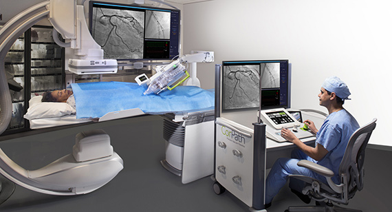

![CorPath robotic assistant in use by surgeon](/media/1020899/the-corpath-grx-system_570x308.jpg?width=570&height=308&rnd=132403984333730000)
Finally, as mentioned, demand for the product initially was inconsistent, though demand has since stabilized. Again, molding worked well because parts could be made only when needed.
