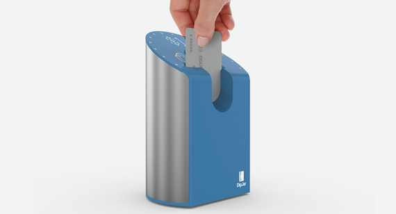

At a business where a DipJar is present, customers simply “dip” or insert their card into the device to leave a tip in an amount set by the establishment. The DipJar, which houses a card reader, circuitry and software to complete the cloud-based transaction, displays the amount tipped and makes a “change clinking” sound to notify employees of the payment. DipJar also is positioning the device as a way for charitable organizations to collect donations.
![DipJar's enclosure is made of ABS plastic](/media/1015064/dipjar-fig-1.png?width=570&height=308&rnd=131799335936570000)
