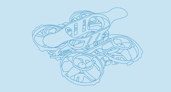

Finger Flyer Drone
Several molded parts comprise the fingerport and Finger Flyer.
The fingerport is a crucial aspect of both the appeal and functionality of the Finger Flyer Hoverboard, and our molded parts were integral to not only the fingerport itself, but also in getting a durable, safe version of the Finger Flyer off the ground and into the hands of consumers.
 “The fingerport allows the drone’s onboard sensors to track the user's motion to initiate pre-programmed flight paths and tricks,” Parker explained. “And the fingerport allows the user to physically manipulate it if they wanted to spin it or pass it to a friend.”
