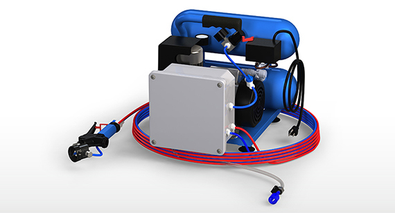

Not surprisingly considering its name, FOAM-iT established itself by making foam units that spread chemical agents over a large area as part of an industrial cleaning process.  It also has a complementary product line that uses stationary equipment to create large volumes of mist/fog as a final disinfecting step. When FOAM-iT introduced mist/fog units that dispense disinfectant from a handheld wand, it gave more control to the end users who sanitize workspaces, allowing for more precise decontamination of a space. “Before the beginning of March 2020, about 80% of our product sales were for foam dispensing equipment,” said Alex Vandertol, FOAM-iT product development and support manager. “Since then, 80% of our sales have been for misting equipment.”
Soon, FOAM-iT discovered that the fragile tip of the nozzle, which dispenses the agent and mixes it with air, needed a protective cover. Equipment operators—who were pressed to work quickly—had a tendency to drop the applicator wand and knock it into the objects they were spraying. That deformed the nozzle, preventing it from smoothly dispensing the chemicals. FOAM-iT engineers began developing a solution.
And then COVID-19 changed everything. Due to the increased focus on safe workplace environments, FOAM-iT was deluged with orders for their mist/fog units and had to pivot to an immediate fix. “We were suddenly getting hundreds of orders for equipment that we'd only sold a few of before, so we needed to react and protect those nozzles,” said Vandertol. “But we didn't think we had time to injection mold a part.”

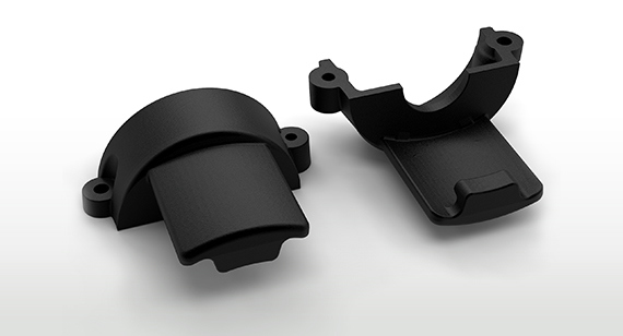

There were several considerations in making the nozzle protector. FOAM-iT engineers quickly worked out a CAD model with the assistance of our design analysis. The interactive feedback helped the company work through functionality and moldability issues, including the location of the parting lines. In the final design, two identical parts wrap around the nozzle’s mount, protruding just enough from the nozzle to protect it. The two parts are joined using two screws on the mist side and a clever undercut snaps the protector to the body of the wand. “One reason we used Protolabs was the ability to create a part with that type of undercut quickly and accurately,” said Vandertol.
The end part was molded using a durable HDPE plastic. It was the perfect choice because FOAM-iT’s customers each have their own cleaning formulation. Chemical compatibility was of paramount concern, and HDPE has the advantage of being a significantly nonreactive material. The desired part color was black, and the part had to be simultaneously rugged and protective, yet flexible enough to take a hit without breaking. HDPE could deliver on all those specs.
Injection-molded nozzle protectors
The nozzle protectors used in FOAM-iTs disinfecting units are molded from HDPE—a durable, non-reactive thermoplastic.
Working with our engineering and sales teams, the CAD file was perfected and FOAM-iT was quickly added into the our system. “It was a Thursday evening when we sent the initial CAD files, and by Tuesday, you had already delivered the 250 prototype parts to us, which we sold very, very quickly,” said Vandertol. "I think we've made at least one or two more production orders of parts since then.”
