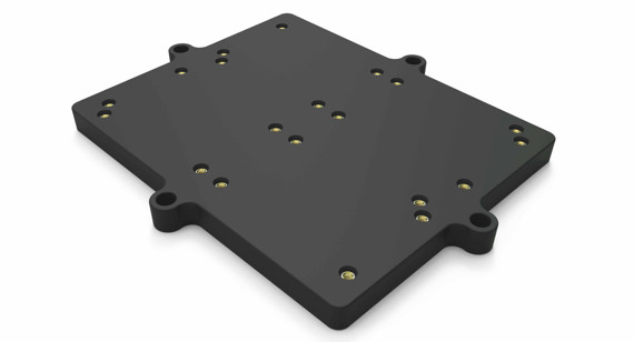

![harris corporation injection molded part](/media/1009895/brass-inserts-black-hr.jpg?width=570&height=308&rnd=132947496340000000)

Murray then developed plastic test fixtures that could hold a number of boards and bolting the fixtures onto the vibration tester. He enlisted Protolabs’ rapid injection molding service to make the fixtures, which are customizable to the varying geometry of different boards. (The fixtures are made of Cycoloy, a PC/ABS resin that Murray said Harris uses in some product enclosures and that he said he likes for its aesthetics and mechanical and thermal performance.)
Attaching circuit boards to the plastic fixtures—with screws from 1 to about 2 millimeters in diameter, with corresponding nuts—proved tedious and time-consuming, Murray said. Adding threaded brass inserts into the bosses on the test fixtures helped somewhat, enabling technicians to use screws alone to secure each board.
But that required a slow, secondary step of installing each insert manually with a thermal press at Harris’ facility, in a process known as heat staking. For a test run of 100 circuit boards, Murray said, that meant first installing 500 small inserts—one at a time, all by hand. And that was before getting out the screwdrivers to fasten the circuit boards to the test fixtures.

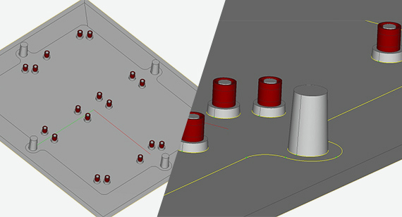

![CAD file of harris corporation injection molded part](/media/1009892/harris-casestudy-fig02.jpg?width=570&height=308&rnd=131429646554730000)

Insert molding involves placing a preformed component—typically a metal part—into a mold and then injecting thermoplastic into the mold to form the finished part. The metal reinforces the mechanical properties of the plastic. Insert molding also eliminates the need for a secondary process such as heat staking or ultrasonic welding to install the insert into an as-molded part.
In Harris’ case, Protolabs’ insert molding enabled Murray to have all of the brass inserts molded into the test fixtures—20 inserts into each of dozens of 6-by-6-inch fixtures—in one step before he received them. That freed technicians from using the hand-operated thermal press to place each insert individually.
“Obviously, having the inserts molded in the part from the get-go was a huge advantage to us because the parts are ready to go out of the box,” Murray said.

Adapting the design of the plastic test fixtures for insert molding required only minor tweaks, Murray said. He based the changes on feedback from Protolabs’ design for manufacturability (DFM) analysis and a conversation with a Protolabs engineer.

From a total cost of ownership perspective, the labor savings Harris realizes from insert molding the plastic fixtures more than offsets the slightly higher cost of the parts and tooling, Murray said. Having molded-in inserts saves two or more full days of labor by eliminating the process of manually installing the inserts in the test fixtures.
“The net was definitely savings compared to our labor cost,” Murray said. “It was more efficient in our testing as well. I’m able to get started sooner. My technicians definitely are happy.”
