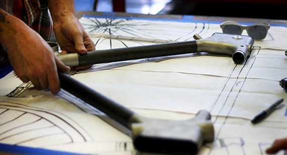

Plug-and-Play Components
“One of the problems with current cargo or utility bikes in the market is that in order to take baskets and seats on and off, you have to bolt and unbolt many of them. Or simply leave them on permanently,” says Harsacky. “With our solution, it’s just as much about being able to quickly rip all of the accessories off and go for a ride, as it is about adding various components.”
To achieve the plug-and-play effect, the team designed a bike frame that combined off-the-shelf 4130 chromoly steel tubing with 17-4 PH stainless steel metal lugs that were integrated into the frame. Due to the complex geometry of the lug design, which included a unique interior mechanism for clipping accessories in and out, engineers at PCH Lime Lab had the lugs build through Protolabs’ additive manufacturing (3D printing) process of direct metal laser sintering (DMLS).
Metal 3D Printing with DMLS
DMLS builds parts in thousands of successive layers, making it ideal for complicated geometries like the bike lugs. A laser system draws onto a surface of atomized metal powder, welding it into a solid. After each layer, a blade adds a fresh coat of powder and repeats the process until the final, fully dense metal lug is formed. “Being in an early prototyping stage, it was much easier to 3D print the complicated lug versus machine it. You get all of the features without having to do any additional design for manufacturability work,” says Harsacky.
Printing complex parts wasn’t the only advantage additive manufacturing brought to the bike’s development. The San Francisco team was able to quickly work through four or five design iterations with an in-house fused deposition modeling (FDM) printer. The FDM printer—that uses a plastic spool and extrusion process to build parts—provided initial design feedback with more rudimentary ABS plastic lugs before moving to metal sintering.
Once all of the iterations were complete and the final stainless lugs were built, the team had to weld them to the chromoly tubing to form the bike’s frame. “Instead of having to jig up a frame, and do multiple complex welds where everything intersects, it was really only a few areas where the tubes attach,” describes Harsacky. “Then you’re performing a really easy circular weld that connects the lugs to the tubes. This cuts down a significant amount of production time as well.”
Protolabs also manufactured a bottom bracket shell in DMLS that worked together with the bike’s crankset, and a DMLS fork crown. Harsacky says that the printed crown allowed for more of an organic design that would have been nearly impossible to achieve by welding standard tubes together.

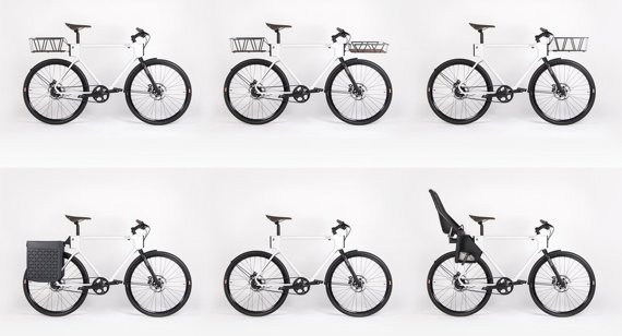

The final EVO bike easily swaps the utilitarian attachments as needed through the front and rear lugs and interior mechanisms; it supports and balances loads during cycling (a cantilever load of 100 lbs. at 2 ft.); and attachments remains firmly secure to eliminate any rattling that might occur. The bike even features a built-in cable lock, a steering wheel stabilizer for loading and unloading, and a lighting system in the front and rear. “Using 3D printing allowed us to integrate a lot of this complexity into one part, which would otherwise be difficult to manufacture in a robust way,” says Jones.
