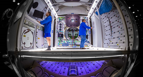

Visual depiction of an earthbound model of the NASA living quarters called the Habitat Ground Test Article currently being developed in Florida.
An earthbound model of the living quarters of NASA’s Gateway port, which is currently being developed at NASA in Florida, is called the Habitat Ground Test Article.
Outcome: Installation and Testing Before Launch
The Protolabs parts for this next generation space mission are now installed in the HGTA and Lockheed Martin’s designs are entering a test phase. NASA astronauts will soon experience the HGTA environment for themselves and help determine if the model they have created meets their needs and expectations. As part of the testing, they will be looking closely at the storage modules that Protolabs has fabricated.
