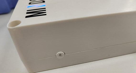

![A view of the top-left side of the Prism](/media/kgpdqrda/prism-img2.jpg?width=570&height=308&rnd=133280343815300000)

Regarding the actual part designs: In order to keep costs down, Mindsett’s team created the design files using free CAD software. Unfortunately, that choice pushed inefficiencies further down the road. Protolabs’ CDS proved invaluable in this respect, speeding the addition of critical features such as draft angles and specialized geometries.
The lens piece that indicates the status of the device’s Wi-Fi connectivity required additional support from Protolabs to ensure the correct intensity. The CDS team gave advice on different finishing options for the lens to achieve the desired result.
