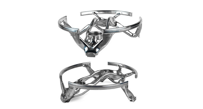

Attendees came together to identify constraints for the generatively designed part, which acts as an apparatus for holding the equivalent of an upside-down 250mL Ehrlenmeyer flask to capture samples of volatile gases released when the moon warms.

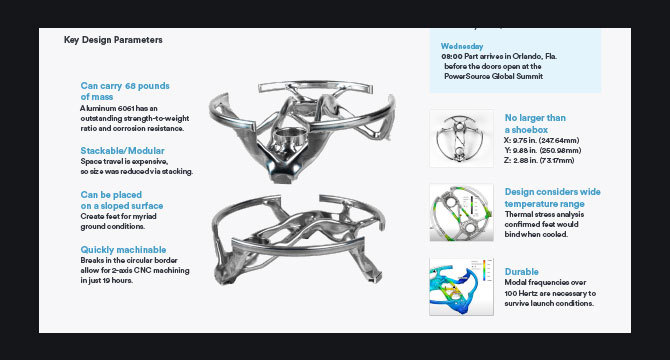

Objects on the moon in the area Artemis will inhabit must tolerate temperatures that can range from -315 F to -55 F (-193 C to -48 C). According to Vaerewyck, the conference engineers had to ask themselves, ‘What does this part need to do and what environment does it need to survive.’ From there, they developed parameters for generating the design, with an eye on optimizing weight and maximizing stiffness.

Whenever lightweighting comes up in conversation, affordable aluminum is the first material that comes to mind, thanks to its excellent strength-to-weight ratio. In this case, the CNC-machined part was made with a form of aluminum 6061 that has undergone processes to enhance its strength and stress relief capabilities. It’s a popular choice for aerospace, automotive, marine, and general manufacturing.
Some of the other key design parameters were that the part had to be able to carry 68 pounds of mass and needed to be stackable. The latter enables multiple copies of the part to take up less space on the spacecraft.
The part required footings that allow it to stand upright on the moon's uneven surface.
Finally, the engineers wanted a part that was quickly machinable. While technologies like 3D printing would offer more design freedom, metal 3D printing would not be possible in the 36-hour window to deliver the part.

The generative-designed part has breaks in the circular design, shedding hours of milling time by allowing for simpler 2-axis milling.
