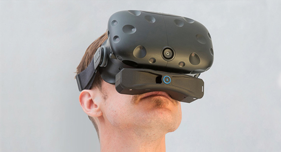

The company’s pioneering product is the OX1, a lightweight, wireless patented device that attaches to the bottom of a VR head-mounted display. To intensify the immersion and authenticity of the VR experience, the OX1 emits microscopic, millisecond-long bursts of various scented liquids into a small area under the user’s nose. The OVR in the company’s name stands for “olfactory virtual reality.”

![OVR OX1 Virtual Reality Product](/media/1018580/ovr-technologies-570x308-03.jpg?width=570&height=308&rnd=132157796492730000)

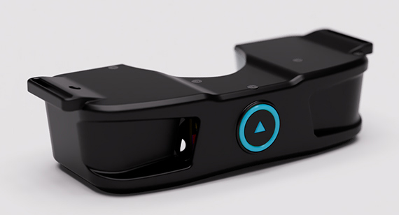

Cooper, along with OVR Technology chief technology officer Matt Flego, made some housing prototypes with a fused deposition modeling (FDM) 3D printer. But that didn’t work for the types of geometry he needed. Scent molecules were sticking in the small grooves the FDM process creates, making them impossible to fully clean out of the housing.
The team at OVR uses another industrial 3D printing process, stereolithography (SLA), with an in-house machine, Cooper said. But the material isn’t as strong and the finish isn’t as close to that of a finished molded part.
Multi Jet Fusion Passes the Smell Test
Cooper gets the flexibility he needs to quickly change form factor along with the finish and strength of end-use parts with Protolabs’ Multi Jet Fusion process. Protolabs’ turnaround times and prices won him over, and its instant design analysis and pricing tools made the process easier, matching his experience on previous parts.
“Protolabs has been helping us with extremely high-quality nylon parts from the HP Multi Jet Fusion machine,” Cooper said.
Cooper also praised the durability of the MJF parts. “We’re going to do testing we would need if we do head into military applications, which it looks like is very possible,” Cooper said. “We’ve got to do drop testing, electromagnetic testing. The parts have to be pretty much analogous to what the final material would be and the Multi Jet Fusion gives us exactly that.”
Knowing he can get parts from Protolabs in a few days—essentially manufactured on demand—helps the startup avoid having a large inventory and further supports rapid design innovation, Cooper said.
![OVR 3D-printed Attachment](/media/1018578/ovr-technologies-570x308-01.jpg?width=570&height=308&rnd=132157796487300000)
