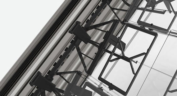

A key component of Skyven's system is the optical mirror technology in each of its solar panels, which Gupta says concentrates sunlight by a factor of 1,000. Each panel contains an array of hundreds of small mirrors with mechanical drivetrains that move the mirrors to track the sun.

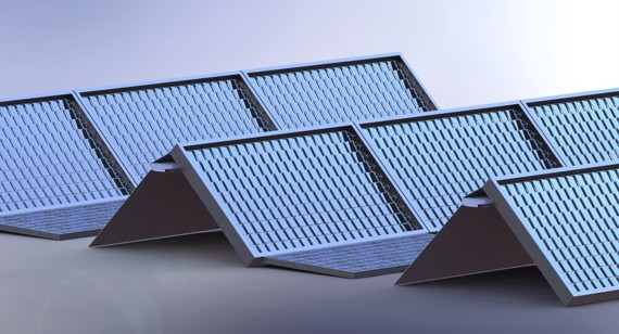

Skyven’s panels are 25 percent efficient at converting sunlight into electricity, compared to 15 to 20 percent for traditional solar panels, describes Gupta. The system is about 45 percent efficient in converting sunlight into heat energy, for a “total combined efficiency” of 70 percent.
Installed on a commercial rooftop, the Skyven Cogen System will produce 50 percent more electricity that will cost 20 percent less than a traditional photovoltaic system, he says. The installed cost of solar water heating with Skyven’s system is 40 percent less than with traditional technology.
![Close-up view of the Skyven Cogen System](/media/1012238/skyven-fig-2-tiny.jpg?width=570&height=308&rnd=131587510917800000)
“There are ways to convert sunlight into electricity with a regular solar panel,” Gupta says. "And there are obviously ways to create heat from sunlight with a black panel. But to do both simultaneously and to do both well simultaneously is where this technology really shines.”
