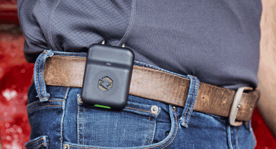

Greg Probert, project engineer at Triax Technologies, led the design of Spot-r as well as the effort to find a manufacturing partner that could quickly produce a prototype and production parts. “As the sole mechanical engineer on the team, at company where most of our development efforts are focused on software, I was looking for an efficient partner that would be easy to work with and reliably deliver parts on time,” said Probert.
His primary design challenge was determining how to handle the product’s assembly. The design consisted of two mating parts that housed electrical components such as the sensor and wireless communication module. A strong seal between the two parts would protect the product’s electronics once Spot-r is deployed in the field.
“The first version of our product was built with molded parts from Protolabs and assembled using a gluing process. This was a large-quantity prototyping run of about 2,000 parts,” explained Probert. After testing the initial design, Probert and his team quickly found the gluing process to be inadequate since the housing could not be disassembled once it was glued together.
“We went back to the drawing board to evaluate other options and settled on using screws to hold the device together. The screws allowed us to easily access the internal components of Spot-r without destroying the housing,” he said.
With the design likely to change with more functional testing, the ability to modify the internal components without ruining the product’s housing was critical.

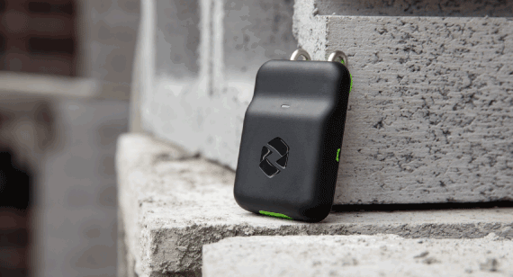

Probert explained the team also wanted to waterproof the device: “We needed a gasketing material to help seal the part. For this, we used Protolabs’ overmolding process to incorporate an o-ring around the perimeter of our design, giving us a waterproof seal.”
The design was manufactured by first molding a rigid part made from ABS and then placing that part into another tool and molding a soft material, Versa Flex, around the substrate to create the gasket. This manufacturing process, known as overmolding, results in a chemical bond between the materials and creates a waterproof seal between the two mating parts. Gaskets are a common application of overmolding, but the process can also help dampen vibration or improve grip on rigid plastic parts.
