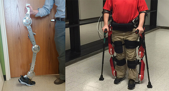

The lab used its own 3D printer to create “version 0.1” of the housing to evaluate the assembly, assembly processes, and how components would stack inside, Gorges said. The lab is using 3D printing to produce carbon-fiber braces for the exoskeleton and casings for electronics. The Baylor College of Medicine in Houston, which has an orthotics and prosthetics program, is making the braces.
Loading tests weren’t possible with a 3D-printed housing, however, so the lab had Protolabs make a small single joint to test. A second version of the housing from Protolabs is now in use with design improvements likely to lead to further iterations. For load-bearing joint components, the lab is using aircraft-grade aluminum 7075 for its light weight and rigidity, Gorges said. The material also offers high tensile strength and corrosion resistance. “The big thing is minimizing size and weight for the exoskeleton but also having reasonable cost,” Gorges said.

All of the parts, including the aluminum housings, have worked well in initial testing, Gorges said.
“Those parts are critical points in the system,” Contreras-Vidal explained. “The housing is not only the location for the actuators and the gear reduction but it interfaces with other parts of the system. We've done a lot of bench tests, we have had this joint going many, many times. They have been doing fine.”
