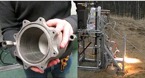

The group’s second-generation engine solves that problem with regenerative cooling, a common concept in rocket design. That method involves cycling the liquid fuel, kerosene, through a spiral channel in the metal engine wall, surrounding the combustion chamber.
The cooling channel is designed to lower the temperature of the metal walls of the chamber from nearly 5,000 degrees Fahrenheit to close to 1,200 degrees. To get the fuel moving fast enough to cool the engine sufficiently requires using just a single channel, which forms descending loops through the length of the engine wall, Deng said. The width of the engine wall also is a consideration, with the structural strength of a thicker wall balancing the greater heat transfer ability of a thinner wall.
“The manufacturing of it is incredibly difficult using conventional methods, especially for a very small engine,” Deng said. “The struggle was how do we get a single cooling channel through this entire engine, coiling around the side of it? That’s where Protolabs came in. 3D printing is essentially the only way to get regenerative cooling on an engine this small and have it be a single channel.”

The students uploaded their 3D CAD file of the part to Protolabs’ online quoting system. A Protolabs engineer suggested modifications to optimize the design and speed the build time, Deng said. One iteration was to change the channel from circular to teardrop shaped for easier printing. Another was to modify the angle where the body of the engine tapers from 60 degrees, which Deng said was typical in rocketry design, to a self-supporting 45 degrees. This change eliminated support structures that otherwise would be necessary to stabilize the part during printing and would add time and cost to the build.
The engine, estimated to weigh about 6 pounds, was produced using the industrial 3D printing (additive manufacturing) process of direct metal laser sintering (DMLS). DMLS uses a laser to fuse powdered metal into almost any geometry, building a part in thousands of very thin layers. Aerospace manufacturers often use DMLS to manufacture small rocket engines and lightweighting manned and unmanned aircraft.
Deng chose Inconel 718, a high-strength, corrosion resistant nickel chromium super alloy, for its high-temperature resistance and other considerations. “The space shuttle’s main engines used Inconel,” Deng said. “We figured if the pros do it that way we’re not going to question the pros.”
