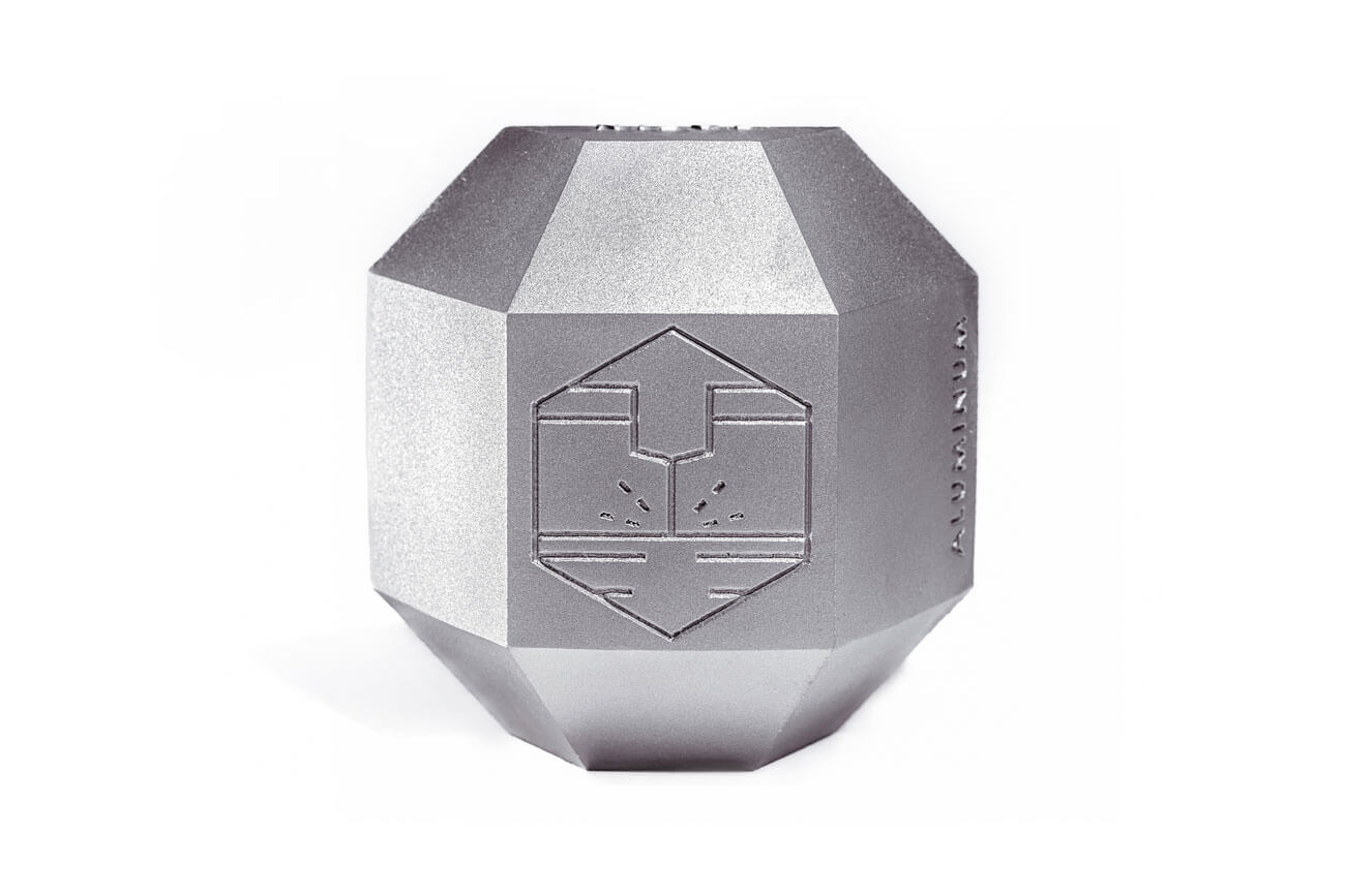

Metal 3D Printing Material Options
Below is our available metal alloys for 3D printing. Various heat treatments are available depending on material.

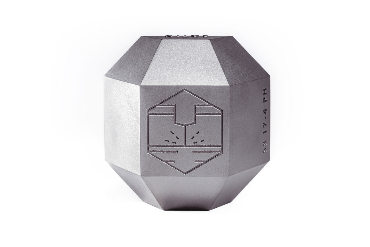

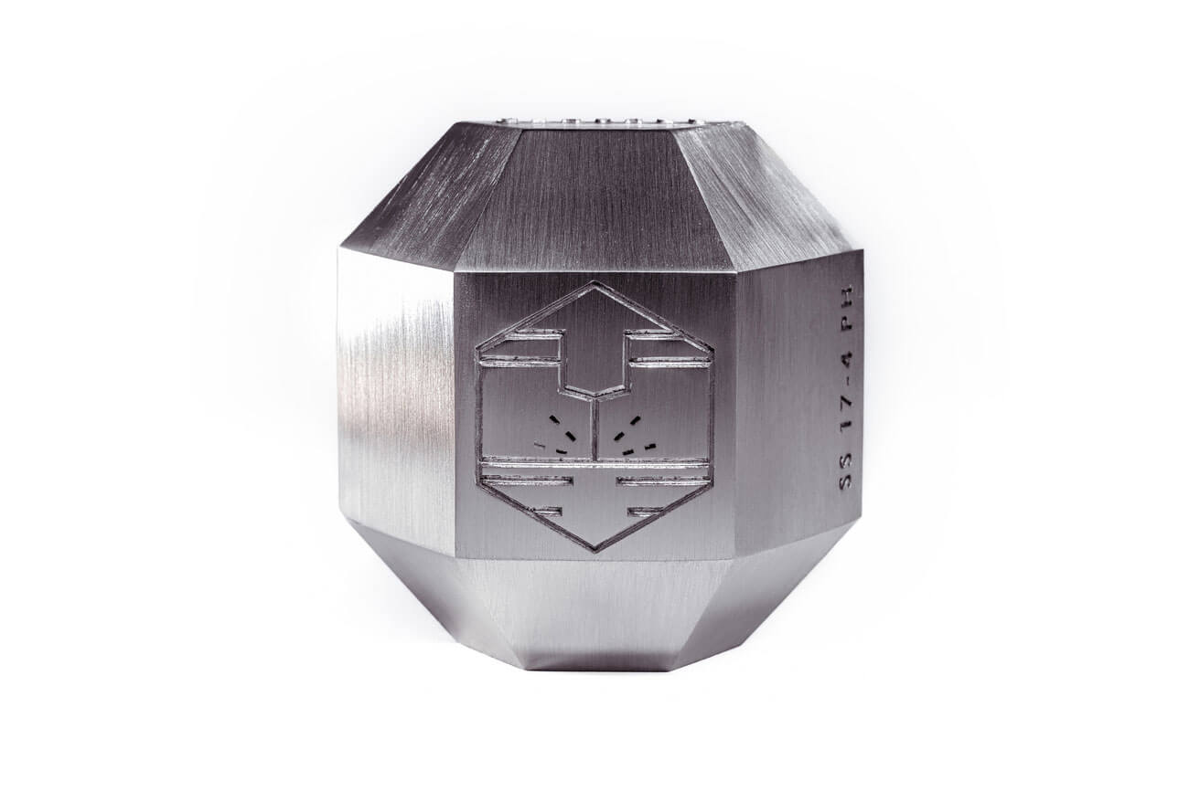

Stainless Steel (17-4 PH)
Stainless Steel 17-4 PH is a precipitation hardened stainless steel that is known for its hardness and corrosion resistance. If needing a stainless steel option, select 17-4 PH for its significantly higher tensile strength and yield strength, but recognize that it has far less elongation at break than 316L. Final parts built 17-4 PH receive vacuum solution heat treatment as well as H900 aging.
Primary Benefits
  • Heat treated for full hardness and strength
  • Corrosion resistance
Finishing Options
Standard
Brushed 150
Brushed 220
Brushed 400
Satin
Polished

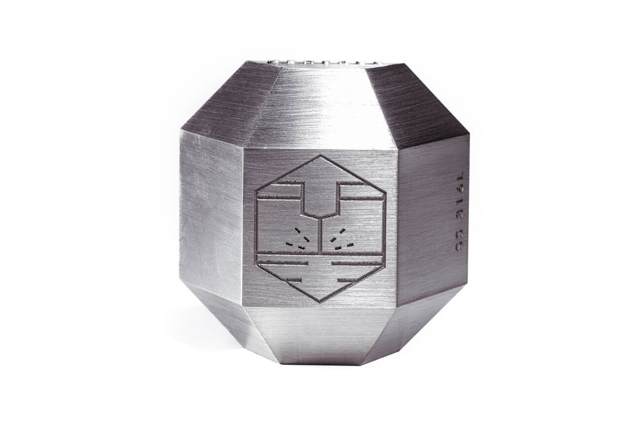

Stainless Steel (316L)
Choose 316L when stainless steel flexibility is needed; 316L is a more malleable material compared to 17-4 PH. Final parts built in 316L receive stress relief application.
Primary Benefits
Finishing Options
Standard
Brushed 150
Brushed 220
Brushed 400
Satin
Polished

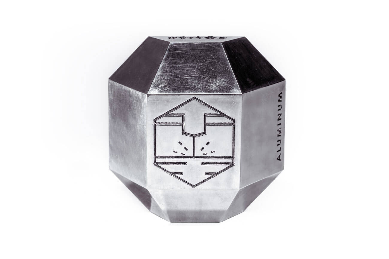

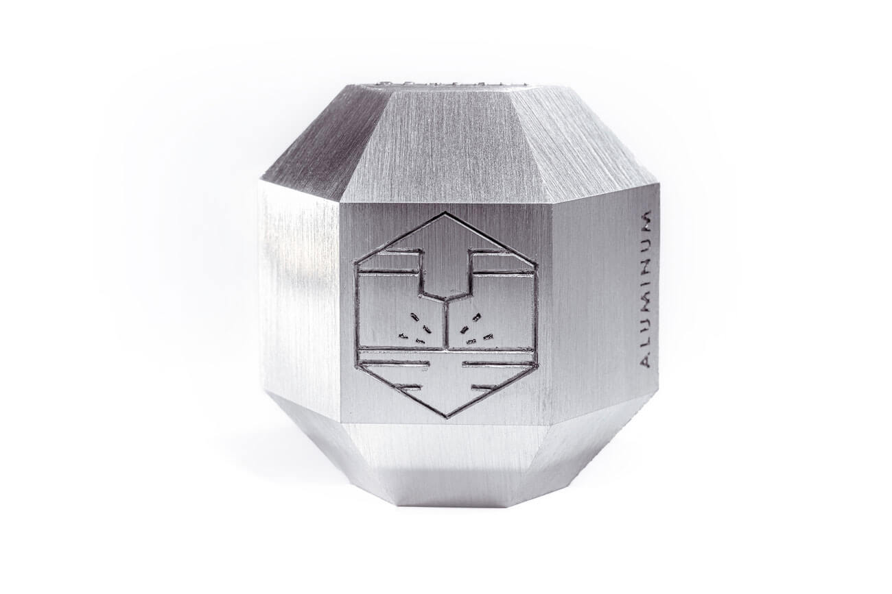

Aluminum (AlSi10Mg)
Aluminum (AlSi10Mg) is comparable to a 3000 series alloy that is used in casting and die casting processes. It has good strength -to-weight ratio, high temperature and corrosion resistance, and good fatigue, creep and rupture strength. AlSi10Mg also exhibits thermal and electrical conductivity properties. Final parts built in AlSi10Mg receive stress relief application.
Primary Benefits
  • High stiffness and strength relative to weight
  • Thermal and electrical conductivity
Custom Finishing Options
Standard
Brushed 150
Brushed 220
Brushed 400
Satin
Polished

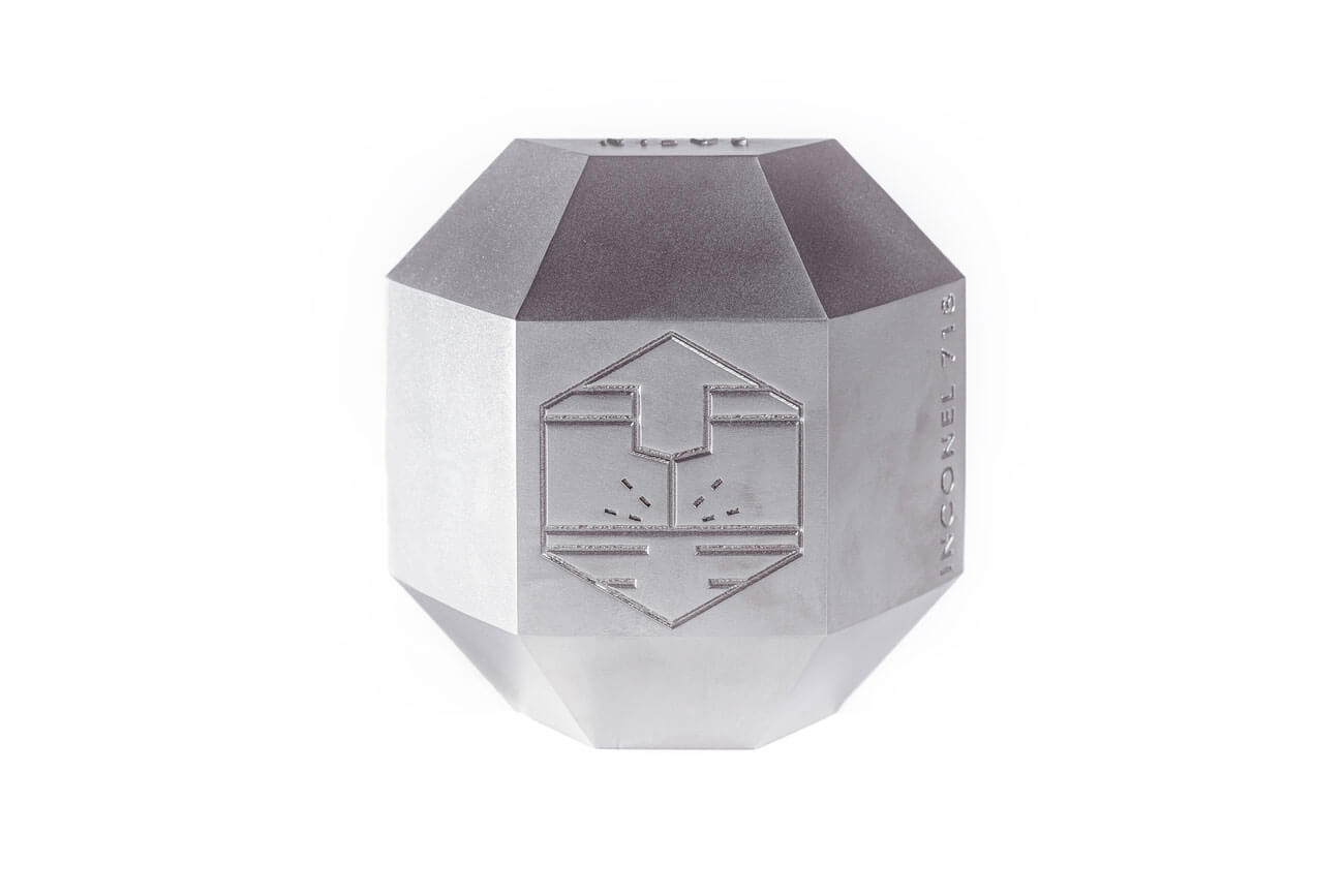

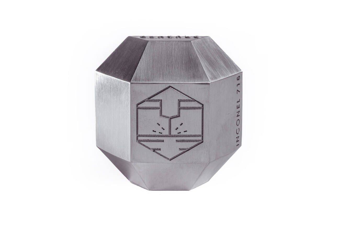

Inconel 718
Inconel is a high strength, corrosion resistant nickel chromium superalloy ideal for parts that will experience extreme temperatures and mechanical loading. Final parts built in Inconel 718 receive stress relief application. Solution and aging per AMS 5663 is also available to increase tensile strength and hardness.
Primary Benefits
  • Oxidation and corrosion resistance
  • High performance tensile, fatigue, creep, and rupture strength
Standard
Brushed 150
Brushed 220
Satin

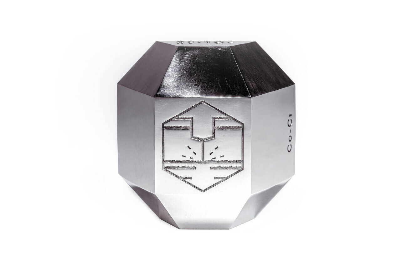

Cobalt Chrome (Co28Cr6Mo)
Cobalt Chrome (Co28Cr6Mo) is a superalloy comprised primarily of cobalt and chromium. It's high tensile strength and resistance to creep and corrosion makes it a good material choice for aerospace components and medical instrumentation.

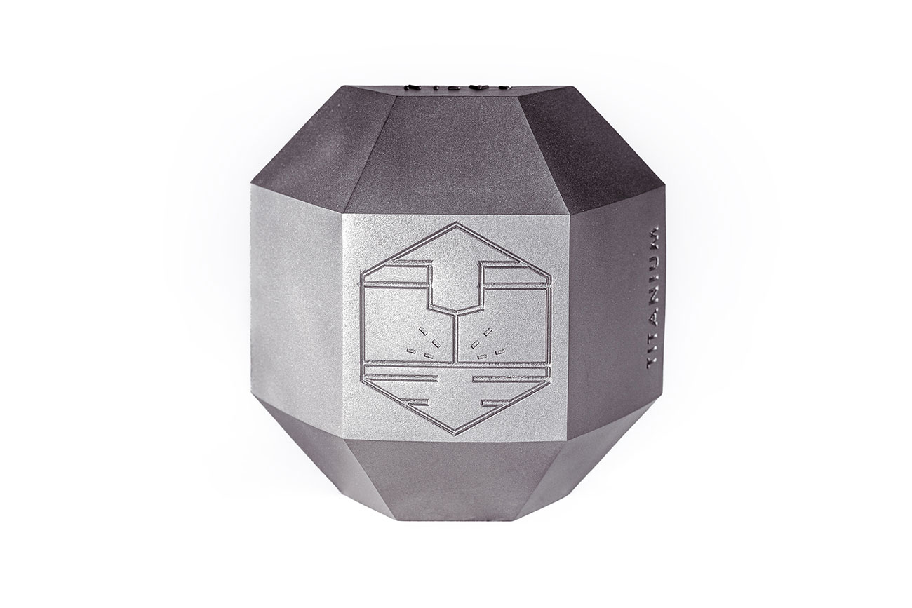

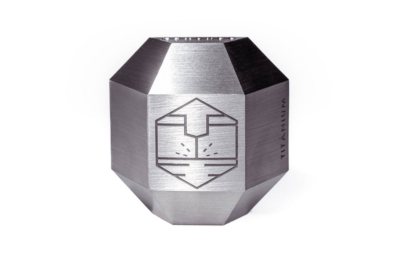

Titanium (Ti6Al4V)
Titanium (Ti6Al4V) is a workhorse alloy. When measured against Ti grade 23 annealed, the mechanical properties of Ti6Al4V are comparable to wrought titanium for tensile strength, elongation, and hardness.
Primary Benefits​
  • High temperature and corrosion resistance
Standard
Brushed 150
Brushed 220
Brushed 400
Satin
Polished
