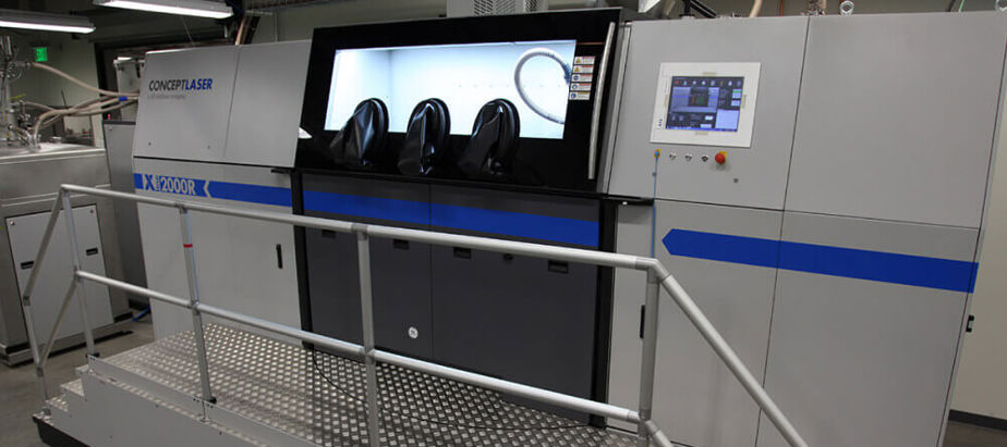

Large Aluminum 3D-Printed Parts
In need of larger additive parts? Our large format 3D printer can support aluminum material and has a build volume of 31.5 in. x 15.7 in. x 19.7 in. (800mm x 400mm x 500mm).
