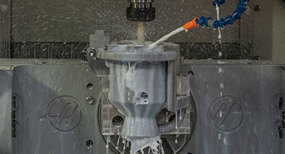

Post-Process Machining
Achieve tight tolerances while having the design freedom of additive manufacturing.
- 3- and 5-axis milling
- Turning
- Wire EDM
- Tapping and reaming
