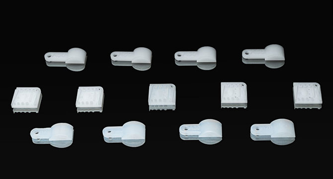

Applications for 3D-Printed Silicone
True silicone is well-suited for small prototyping runs before investing in tooling for injection molding or manufacturing silicone parts with complex, organic geometries. Typical parts include:
- Custom, patient-, or customer-specific parts
- Seals, gaskets, and grommets
- Keypads and buttons
- Surgical models
- Dental liners
- Wearables
