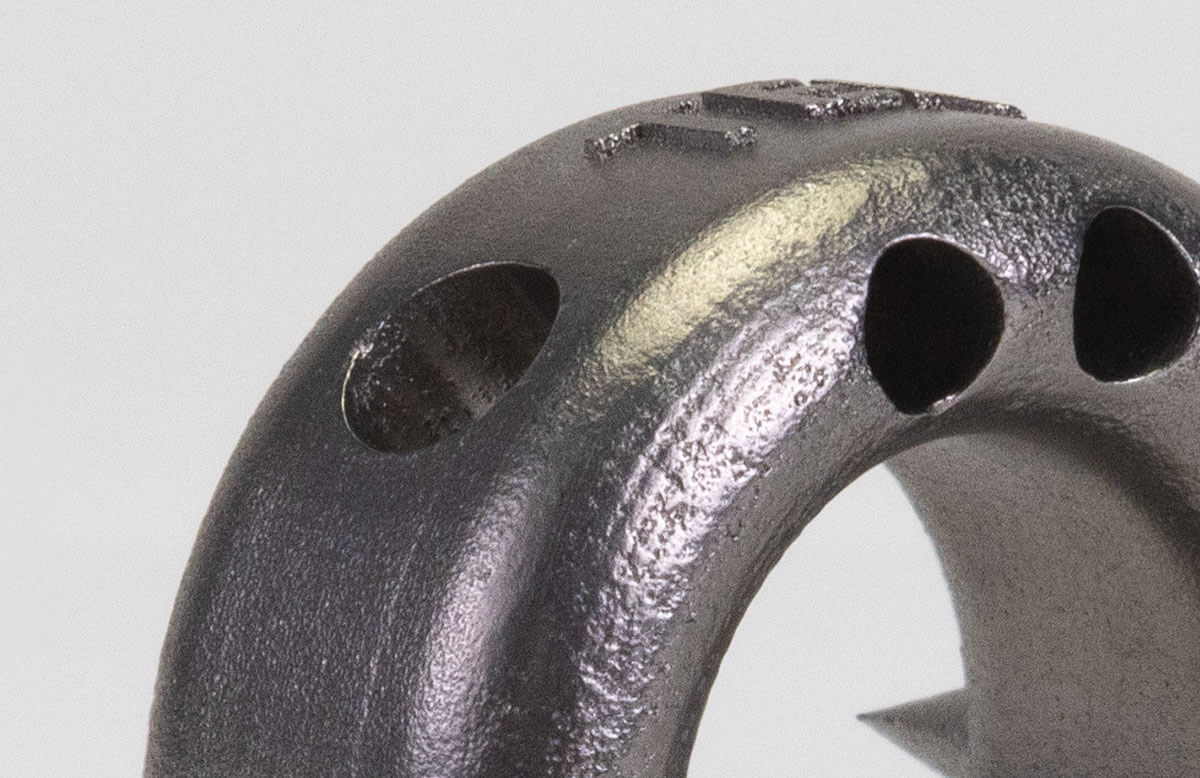

Standard
Expect roughness values of 200 to 400 µin Ra (0.005 to 0.010mm Ra), depending on material and resolution. Support structures are removed and layer lines are visible.
Custom
Custom finishing for metal 3D-printed parts includes post-processing machining, heat treatments, and several brushed surface finishes in a range of grits. View a complete list of custom finishing options.

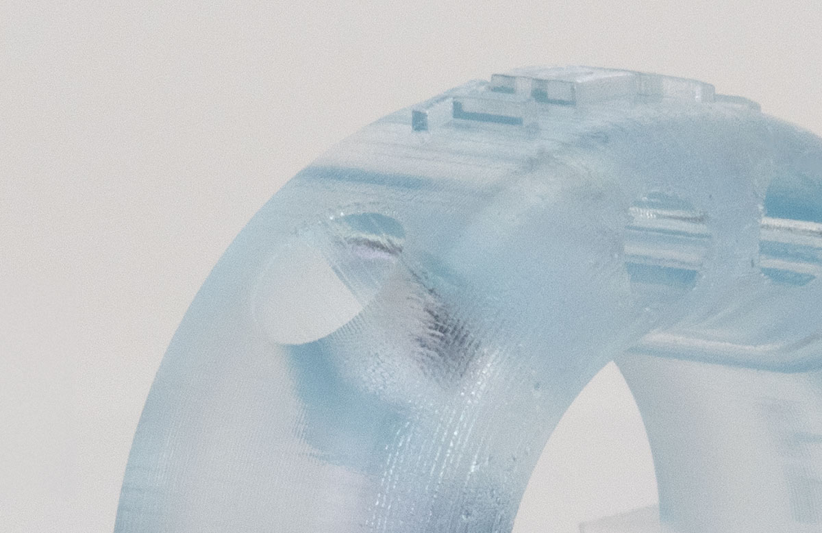

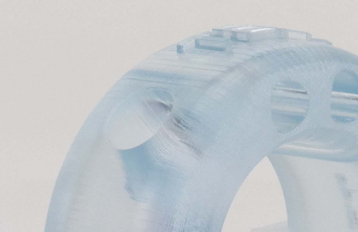

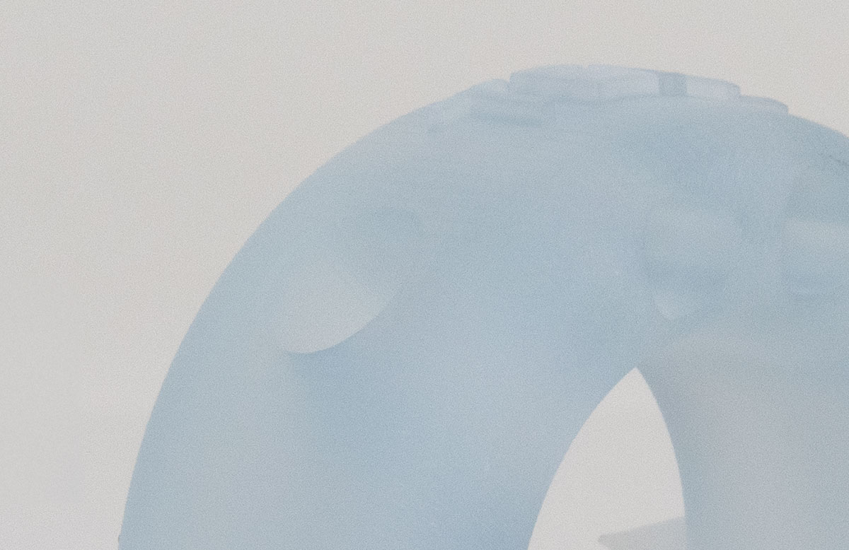

Stereolithography
Unfinished
Dots, or standing "nibs," remain evident on the bottom of the part from the support structure remnants. Good for when fast lead times are required or cost is a factor
Natural
Supported surfaces are sanded down to eliminate the support nibs.
Standard
Supported surfaces are sanded, and the entire part is finely blasted for a consistent look. Note that the layers are still present.
Custom
Soft-touch paint, clear part finishing, painting, masking, color matching, decals/graphics, and texture finishes are available. View custom options

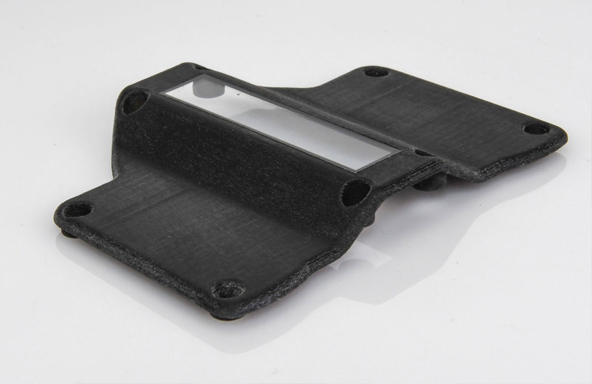

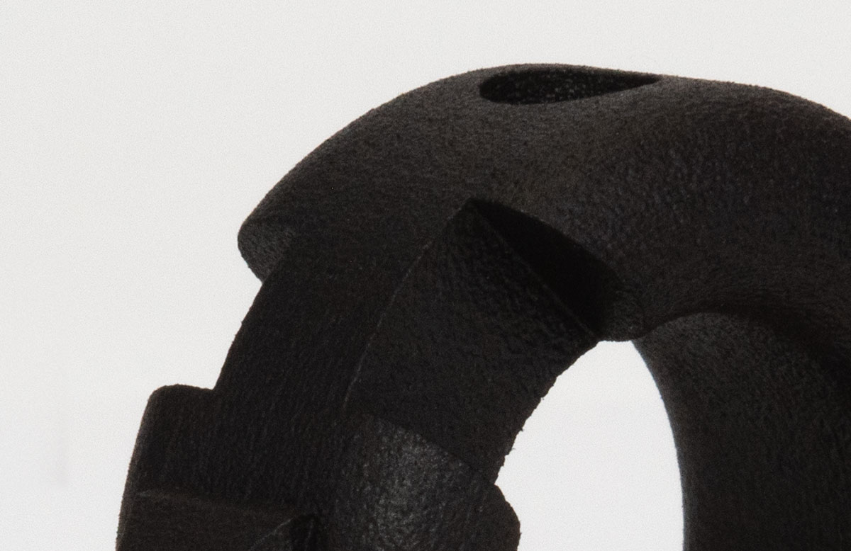

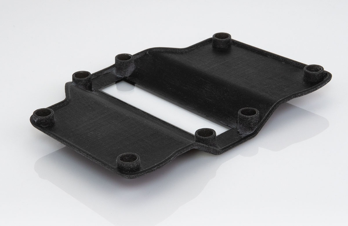

Multi Jet Fusion
As-printed
Parts will be gray in color and slightly rougher in texture compared to standard finish.
Standard
A bead blast removes all powder and leaves a consistent overall texture. Parts are then dyed a standard black color.

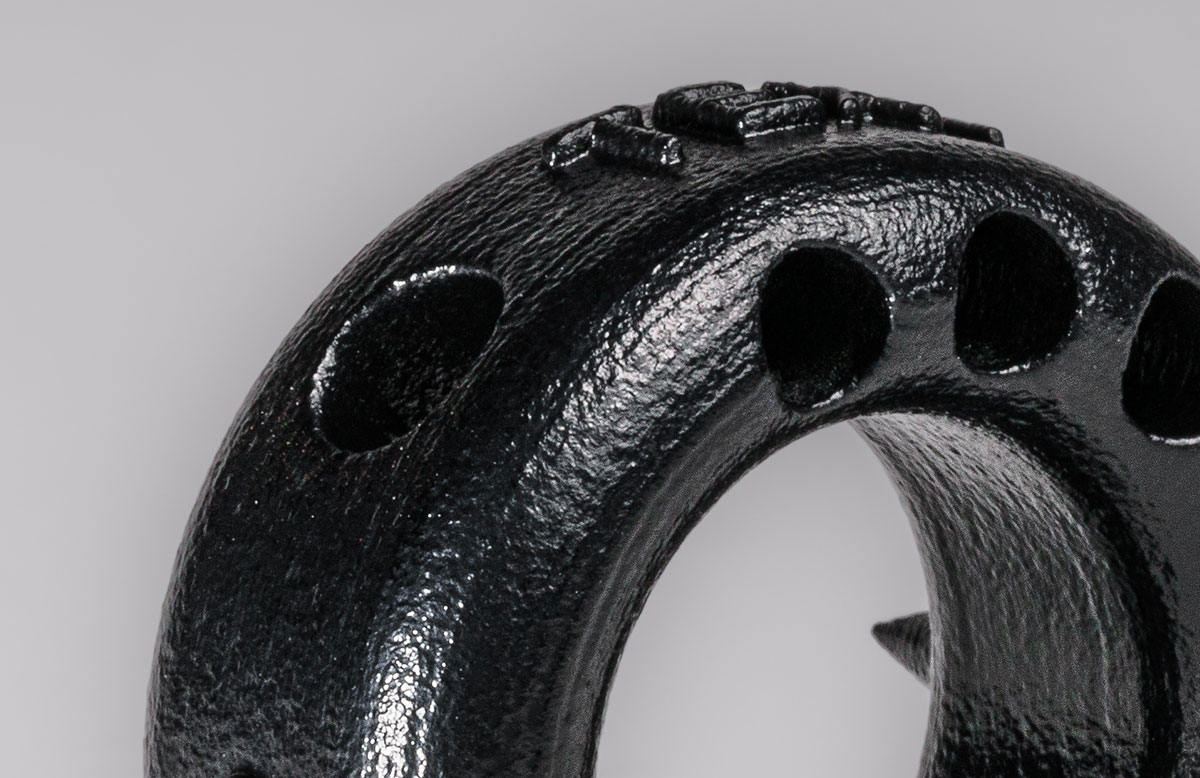

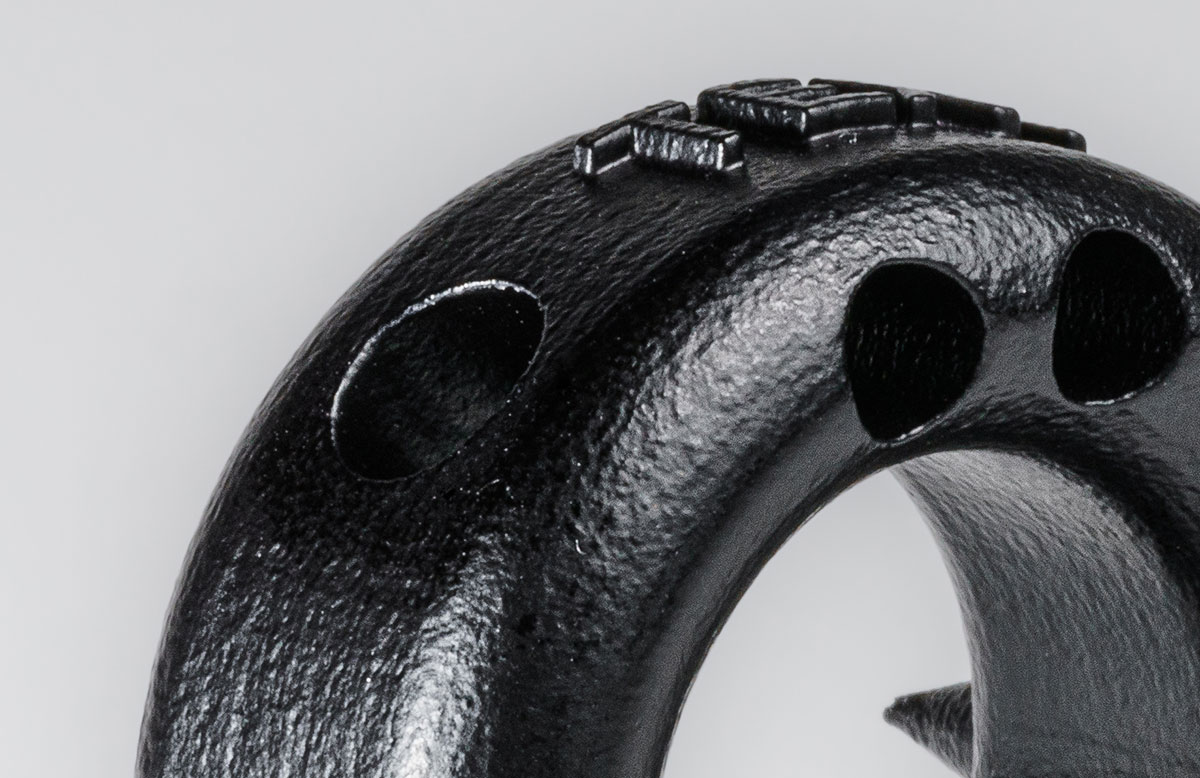

Vapor Smoothing
Significant reduction of surface roughness from 250+ μin RA (as-printed) to 64 – 100 μin RA after smoothing. Available for PA12 Black and PA12 40% Glass-Filled Black.

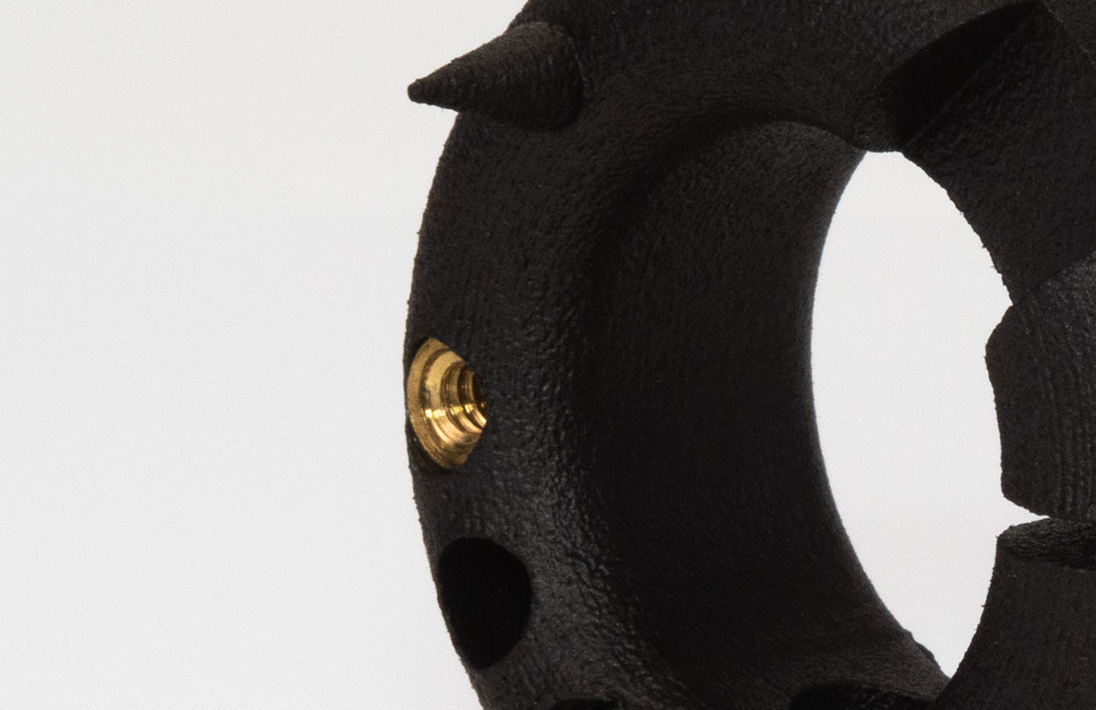

Custom
Common post-processing options for MJF parts include a primer that can be applied, as well as taps and inserts. View custom options

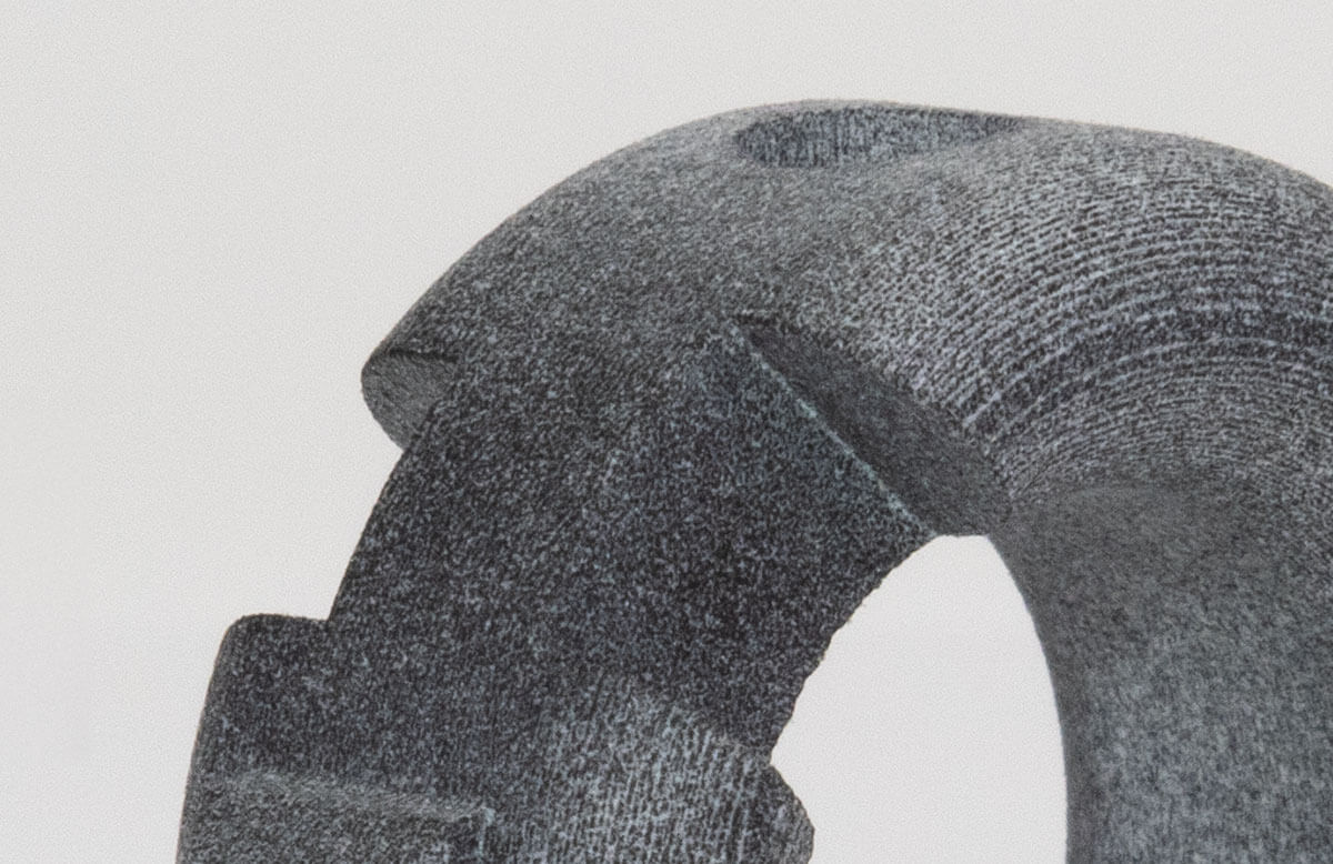

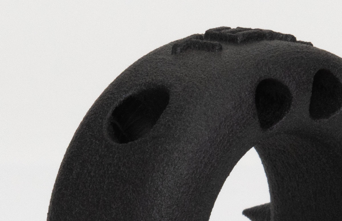

Selective Laser Sintering
Standard
Parts are bead blasted to remove loose powder and create a smooth matte finish.
Vapor Smoothing
Significant reduction of surface roughness from 250+ μin RA (as-printed) to 64 – 100 μin RA after smoothing.  Available in PA 11 Black, PA 12 White, PA 12 40% Glass-Filled, and TPU 70-A.

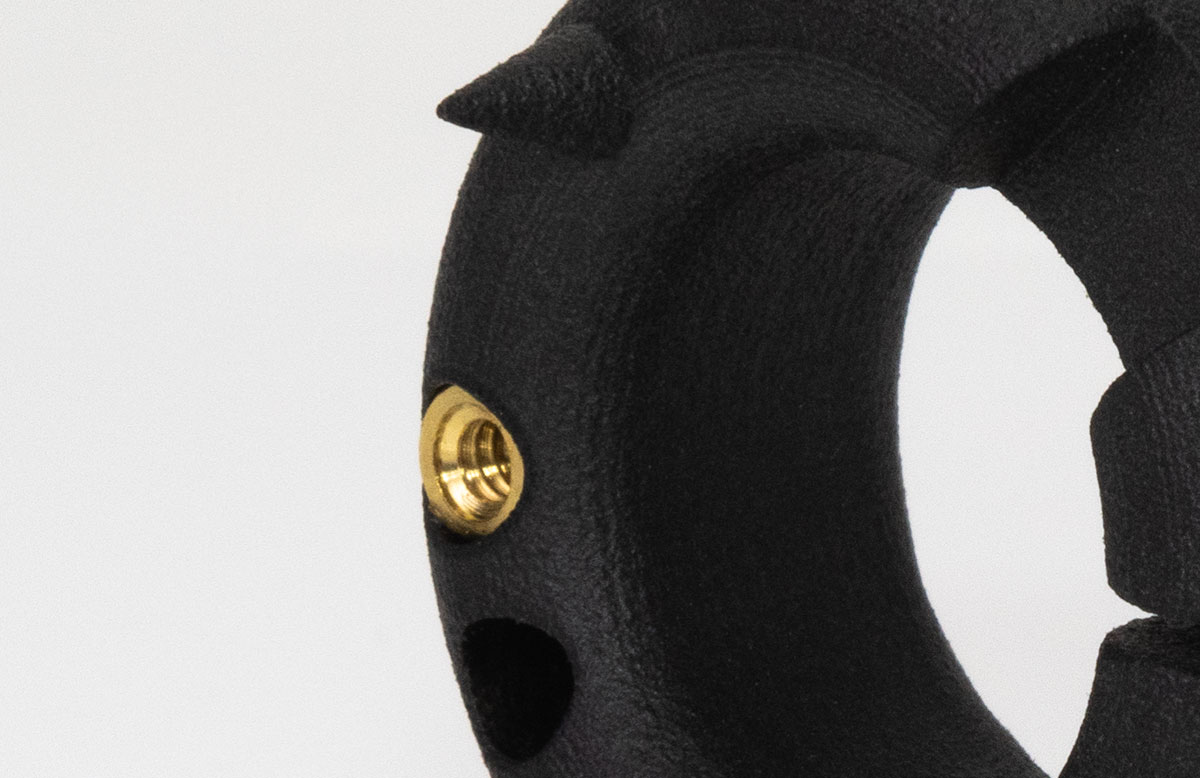

Custom

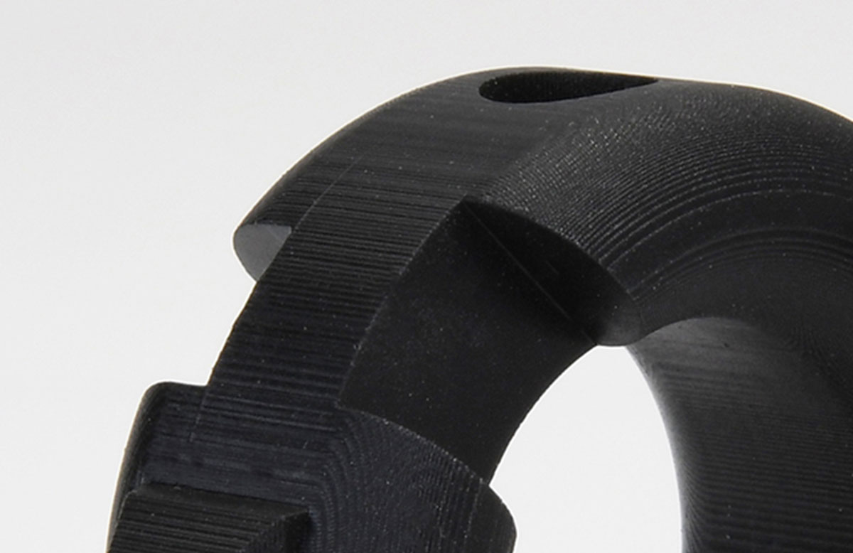

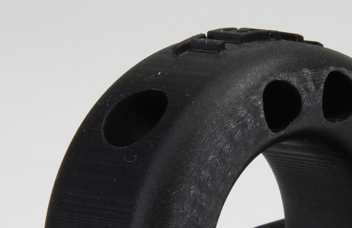

Carbon DLS
Natural
Aesthetics will vary based on build orientation. Standing nibs are sanded flat.
Standard

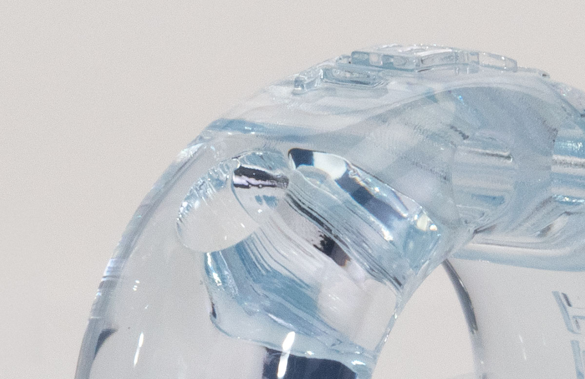

Clear Coat   Applied to plastic parts to create a clear, glossy finish. Ideal for lenses and other optical applications.

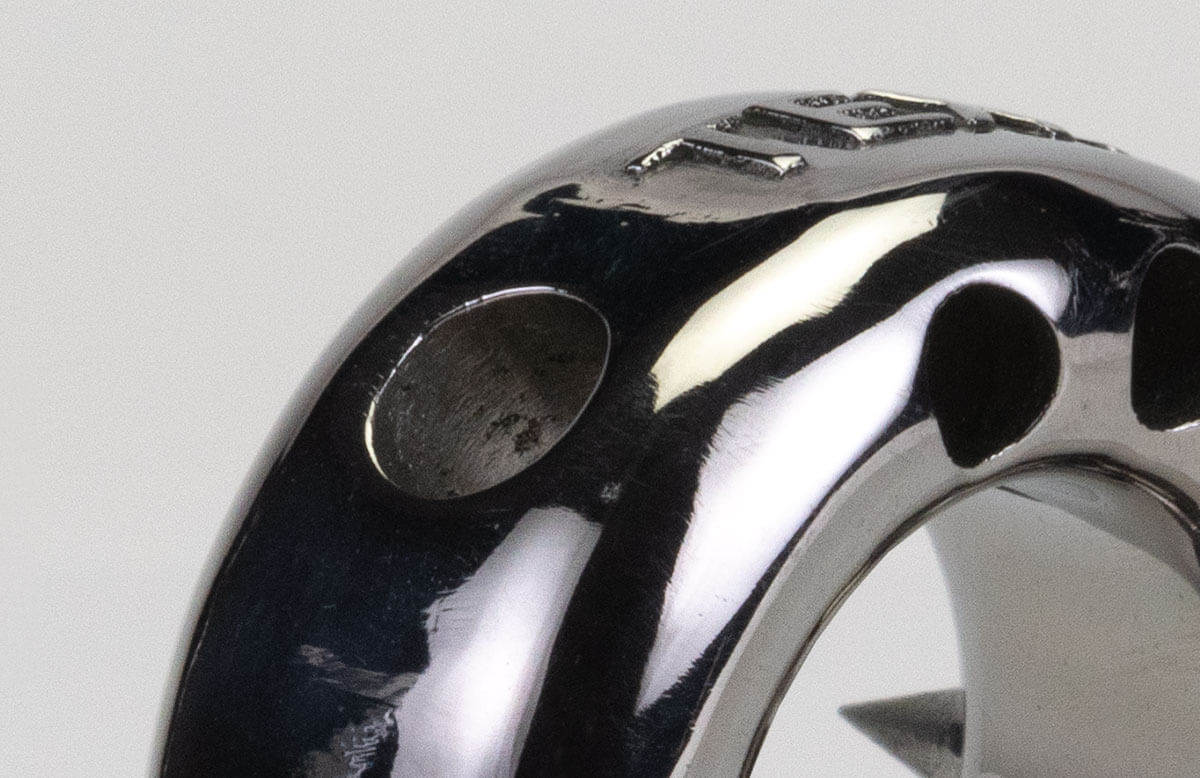

Polishing Brushed and polish surface finishes are available upon request.

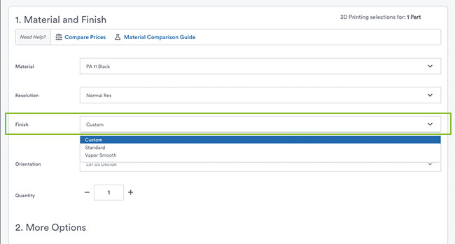

How to Order Parts with Custom Finishing
Step 1
In your quote configuration, select “custom” from the finish drop-down menu. From here you will be prompted to describe what type of finish you are looking for.
Step 2
By adding a request for custom finishing, this will trigger a manual review of a quote and an applications engineer will reach out to you to learn more about your part requirements and provide recommendations on a path forward.
Step 3
You will receive a link that will bring you to a final quote that includes the custom finishing required. Place your order and wait for your custom finished parts to arrive.
