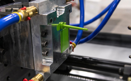

![blue injection molded part](/media/1020237/service-page-hero-im-rev-627x376.png?width=504&height=302&rnd=132925971655170000)
Injection Molding Services for Custom Parts
Custom injection molding for plastic prototypes and on-demand production parts in as fast as 1 day. Request an injection molding quote today.

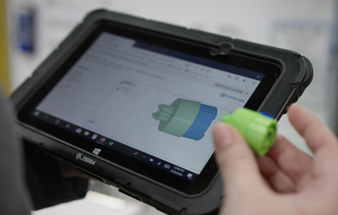

Design for Manufacturing Feedback
Every quote includes real-time pricing and design analysis. We evaluate your 3D CAD and help identify any features that may pose challenges during the molding process such as difficult to machine undercuts and insufficient draft.

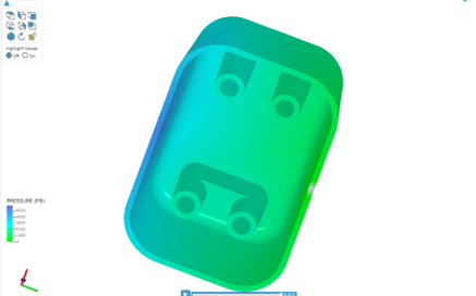

We do quoting a little differently. When you request an injection molding quote, you'll not only receive accurate pricing, but also a manufacturing analysis—within just a few hours. Our online quoting platform also provides you with gate and ejector pin layouts and a price curve tool to help select the best tooling option for your project.
