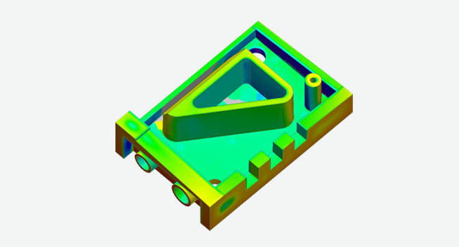

Enhanced Quality with Digital Inspections
Digital inspection reports on molded parts are available on every on-demand manufacturing order. Our metrology lab uses a 360-degree, 12-position 3D scanner that collects data, identifies dimensional variance, and creates a visual aid and color map for a direct CAD-to-scan comparison.
