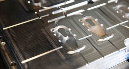

Mold texturing
Mold Texturing & Engraving
Mold texturing and/or engraving involves applying industry standard textures to a mold and/or engraving the mold cavity with graphics/text.

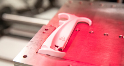

laser engraving process
Laser Engraving
Laser engraving is applied directly to the parts with information such as logos or part numbers. This process ensures crisp, consistent information on each part.

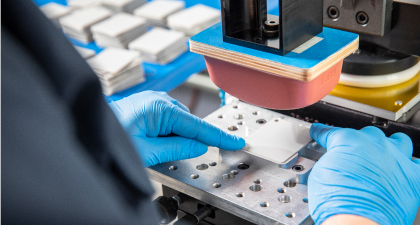

pad printing process
Pad Printing
Transfer a two-dimensional image, like a company logo, onto a three-dimensional object. All images are reviewed for size, color, and complexity restrictions.

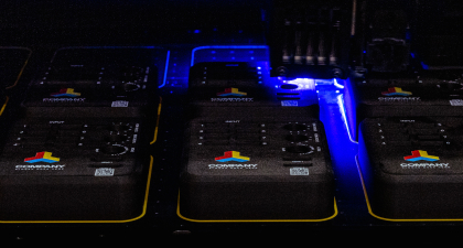

UV Printing Process
UV Printing
UV printing uses state-of-the-art flatbed UV inkjet technology to print directly onto a three-dimensional object. Images can be very small or very large, simple or complex, and contain numerous different colors. For accurate printing, images should be provided with clearly marked locations relative to the part's geometry.

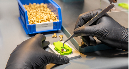

adding threaded inserts to an injection molded part
Threaded Inserts
We stock and install a variety of commonly used standard inserts in UNF and metric sizes, find a catalog of stocked inserts here. We can also accommodate customer-supplied inserts designed for heat staking or ultrasonic installation methods.

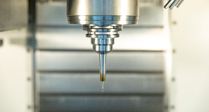

CNC Milling Tool Point
Machining
Machining involves using tools to add precise features like holes, threads, and pockets to a molded part after its initial formation. These additional features are necessary to achieve specific functionalities and fit requirements that cannot be achieved during the molding process.

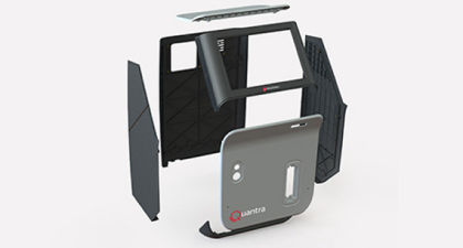

injection molded part assembly
Assembly
Our standard assembly service includes putting together molded parts we've made, applying labels to individually bagged parts, and installing pins or inserts. We can also kit multiple parts together for easy assembly.
