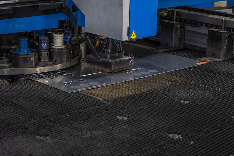

What is Punching?
Sheet metal punching is a metal cutting/manipulation process in which a punch press applies force to material using tools referred to as the punch and die to create profiles, holes, and other formed shapes.
The punch shears the sheet metal against a die in a fast, repetitive process to create a precise series of features and cutouts.
Types of features that can be punched through the Protolabs process include:
  • Countersinks
  • Part profiles/perimeters
  • Hole features
  • Perforation patterns
  • Formed features (e.g. ribs, dimples)
Precision punching adds features to your project with unmatched accuracy.
