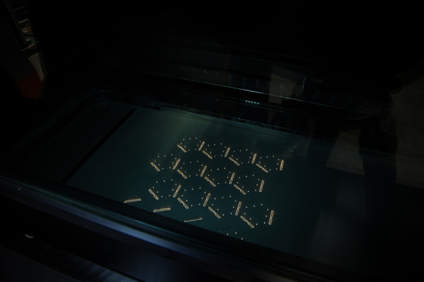

In comparison, metal 3D printing builds your part layer-by-layer from a vat of powdered metal. Once the layer is complete, the build drops down into the vat and a new layer of metal powder recoats the surface for the next pass. It uses powerful lasers to melt and grow the part. While it takes a while to build parts—especially large parts—the parts are as rugged as those that are cast, achieving nearly 100% density.

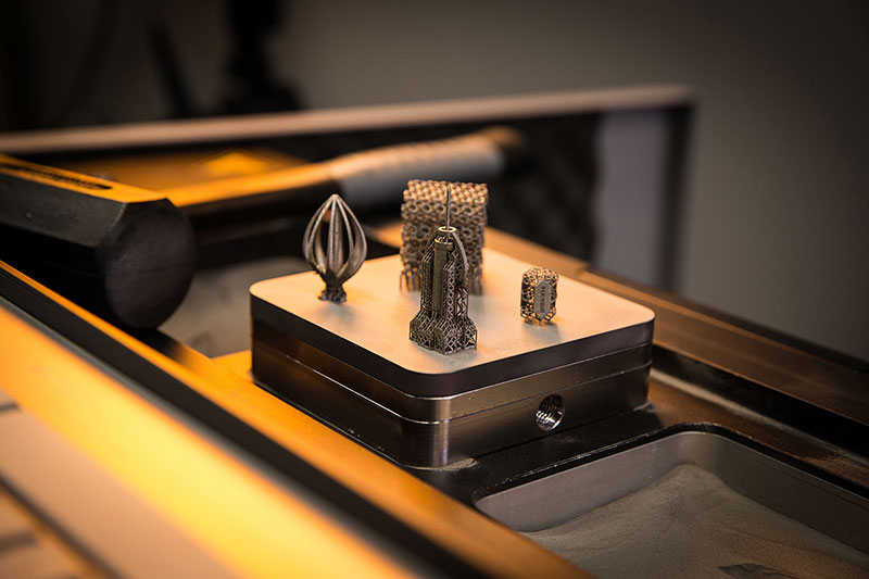

If your part has simple geometries and doesn’t require additional finishing, you can use casting and (eventually) simply remove the part from the mold. However, parts with complex geometries and intricate design with smaller features are likely best 3D printed. The overarching reason for this is that, with casting, it is difficult to get liquid materials to flow through small features built into molds, yielding incomplete parts. Meanwhile, 3D printing excels at building out small features, followed by remedial work after the print to remove support structures necessary to start the build.

While metal 3D printing can be used to make large parts (as noted above), it excels at rendering complex geometries, prototyping in production-grade materials, creating functional end-use parts, and even allows you to combine parts that otherwise would have required assembly. Generally, it can provide smaller parts than casting much faster if no mold is available, even if the parts have quite a lot of detail.
