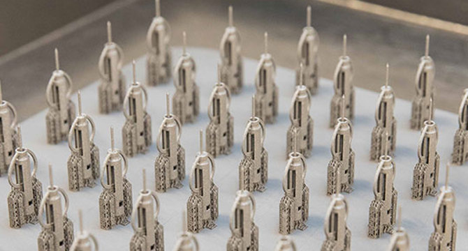

That is essentially DMLS. As in every other additive manufacturing process, part quality is very dependent on a sound build strategy. For starters, DMLS requires support structures to hold features in place as the part is being built. Without them, flat areas may curl—a T-shape would turn into a Y, a dinner plate would become a pie tin. For the most part, Protolabs customers can leave support placement to the DMLS experts, but should understand that unsupported surfaces do tend to warp during the build, and secondary post processing will be needed to saw, grind, or machine those supports away.

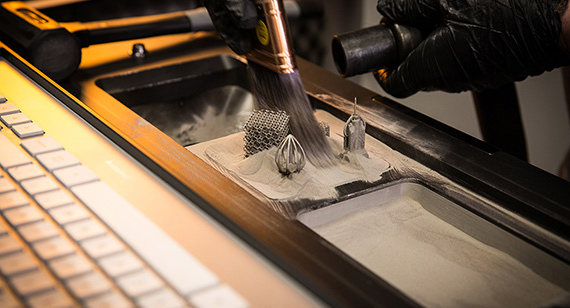

Removing powder after metal 3D printing build
Metal powder is brushed away from a bed of intricate aluminum parts.
